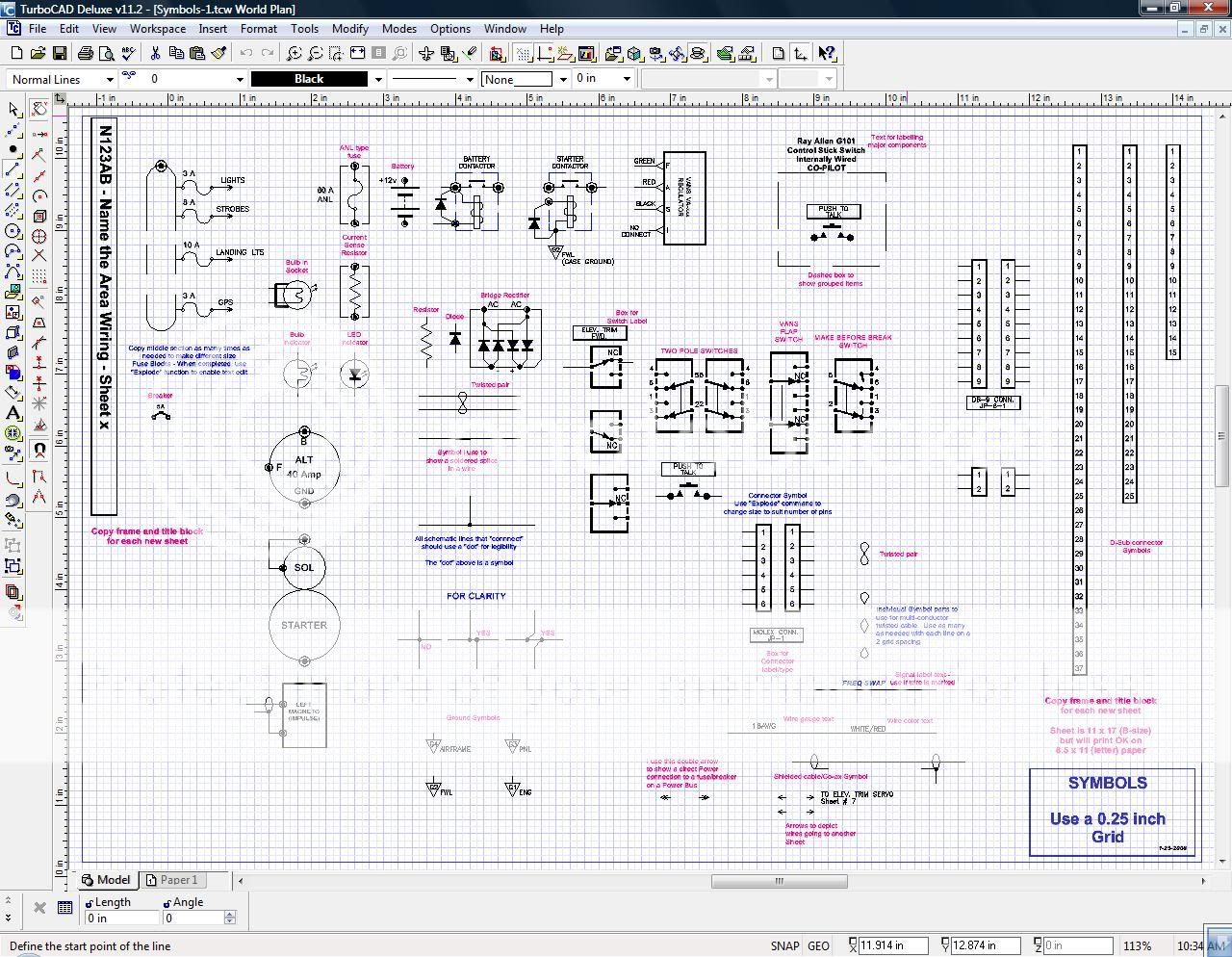

Does anyone know of a free electronics schematic symbols library in .dwg format?

If you are using the cheaper TurboCAD instead of the expen$ive AutoCAD, then you will find that Bob's .dwg files don't translate well.
I have a set of TurboCAD symbols and a sheet template available if you want - example here -

IIRC TurboCAD imported the AutoCAD symbols OK, but lost the reference points.
To draw schematics easily you need a good grid and all of the lines and symbols to accurately "snap to grid"...
My sheet above shows 0.25 grid, but I later changed it to a 0.2 inch grid to get more on top a single sheet. If you go any smaller you probably have trouble reading a letter size printout.
