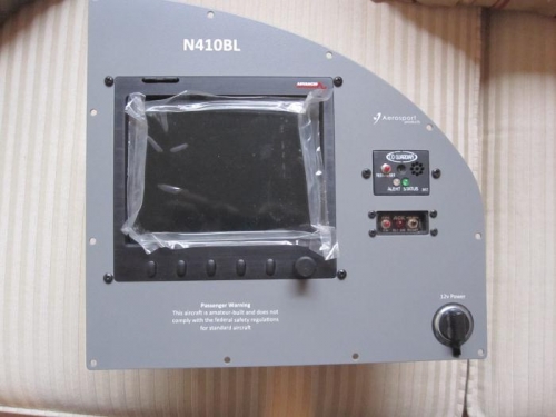

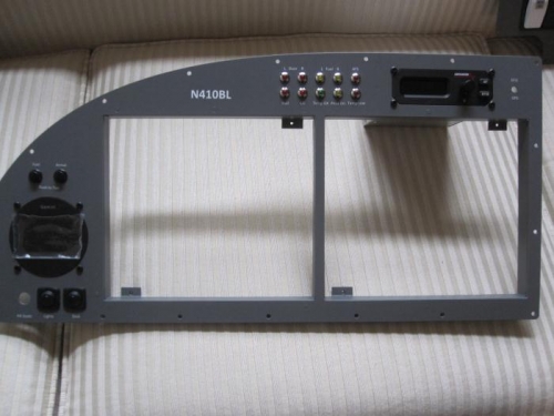

You can also go to your local print shop. Most of them can print dry transfer labels. All you have to do is to clear coat afterwards to make them more durable. Pretty easy and straight forward.
If you apply them crooked, you can use a piece of tape to remove. Just make sure you have multiple copies of each label and/or graphic in case there are any application mistakes.
Usually it's a fixed price for anything you can fit on a 8.5x11 sheet for a single color. You can use your favorite application to generate the text and graphics, then just give the printer a PDF file of the final output.
Here are a couple of my panel inserts:
