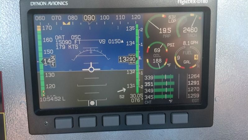

cruising up high
race prep....this was 13gph 2600rpm. sorry the pic is chopped off. It's tough to take a no-glare pic while running flat out looking for birds.
A lot of my flying is between 8500-12500. I flight plan for 175kts 9gph and always do better than that.
