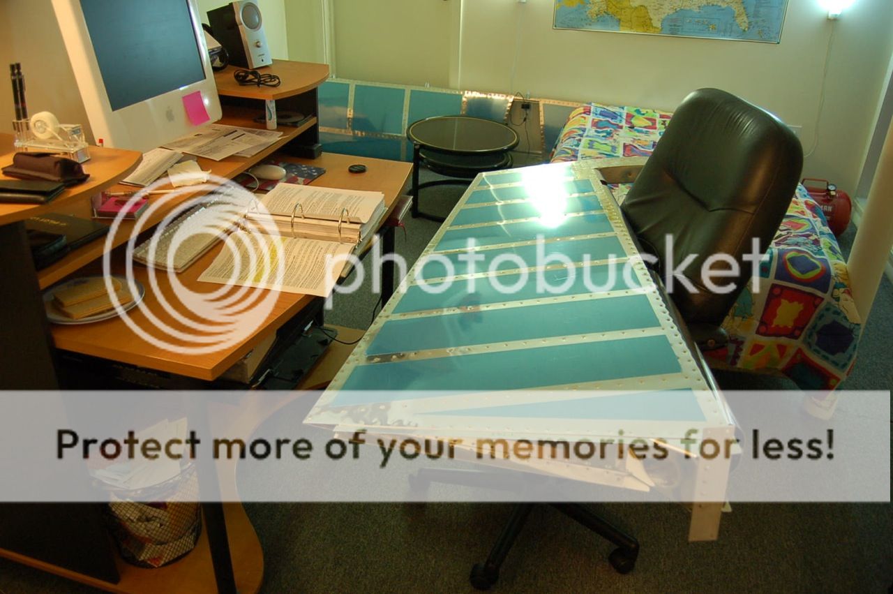

Old 06-16-2013, 07:02 PM
Posts: 8,145
Talking
Jim, aggressive builders don't need no shops. Do you have a kitchen? Is there a table? You can use a closet door as a workbench top.
If you are lucky to have a living room or bedroom use it for storage
The rest is luxury
PS You understand it's a joke but I indeed built my RV-9A empennage in a NYC studio apartment.
