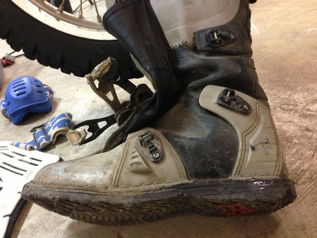

After my Dirtbike boot's sole started talking too me last weekend, I searched the Internet to figure out how to fix it. No one online seemed to have any luck glueing the soles back on, they couldn't find a glue to stick to the materials and remain flexible enough.
I thought the ProSeal was pretty tough and flexible removing my fuel tank covers to perform the service bulletin and thought I would give it a try. I smeared ProSeal on the sole/boot and put bucking bars inside to weight it down. The real test will be hundreds of miles in Co next month!

I use Proseal of different types for nearly everything needing glued,sealed or filled...it is widely used on Heavy Jets for window sealing, fuel tanks, panel sealing , rubber galley floor seams, void filling and yes, I have fixed many boot soles. It is impervious to virtually anything, fully paintable, and compatable with almost any media. If you restore old cars..seam seal floorpans, body joints, gas tanks..bla bla bla. Fortunately for me, I have access to the "out of date" supply at my day job, so cost isnt a factor.
Hopefully you cleaned the area well before you added it, it doesn't stick to dirt.
