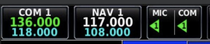

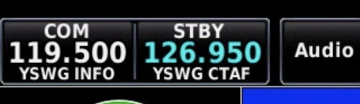

Could not find "Minimized Option for COM Radio Controls" in the Pilot's Guide index. How does it work when you push it?
Thanks.
Minimized COM Controls
Thanks.
Ed,
See page 29-128 of the Installation Manual.
Justin

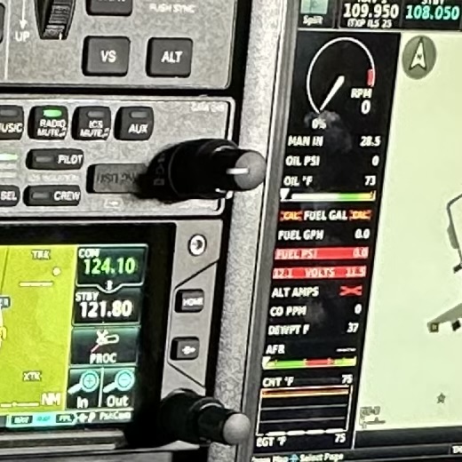

If the pic is representative of the new engine data displayed on the side in the split screen mode (synthetic vision and map with the engine data on the side) with no full set of CHT n EGT data displayed, sorry but that is a step backwards. The full set of CHT’s and EGT’s should always be displayed on the split screen without having to go to the engine page. Why are the MP and RPM gauges so BIG?
AFS, Dynon, and GRT has all the engine parameters displayed on the split screen page, why is Garmin having so much trouble?
It's an extreme example showing what's possible if you select the text-only option for every single possible parameter. You don't have to set yours up the same way.
Then don't change to any of the new engine data field options as shown in the sample an keep things the way you like them. I believe the screen shot shown was a way to explain all the field options available and not imply that would be a good depiction used in actual flight. Unless you were doing some specific test flight where real-time engine diagnostics is bein done.

The point I’m making is AFS, Dynon, and GRT show the entire engine and aircraft data on the same screen as the split screen. Garmin is unwilling to do that. They continue to take up 1/3 of the engine data with the RPM and MP gauges. So they come up with text data removing the full CHT/EGT graph. You have no idea if the single CHT/EGT data shown on their text data option is way off from the other 3.

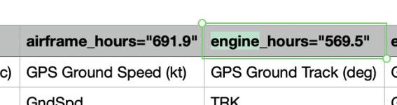

Currently the data uploaded to Savvy doesn’t have any hobbs or Tach time. There is no reason not to include it with every other parameter that is being collected. I’ve told multiple times over the last 1.5 yrs. It’s a simple 5 min s/w change to include those 2 parameters and they refuse. And don’t tell me to dump the raw data into excel to see the hobbs and Tach start times, totally inconvenient. I have several other things but it’s not worth the frustration.
You're right that Savvy doesn't show it, but it IS in the G3X logs files.
I am confused.
What’s missing from this that you can’t live without?

My G3X Touch EIS display was already showing me everything I wanted, but this software update allows me to fit one or two more non-critical parameters, which is a bonus. Of course every monitored parameter is always available on the Engine page (accessible via a single touch) and will produce a CAS alert if properly configured.

electrical - volts or amps, based upon your preferred approach. Also, Fuel Remaining (in numerals). I have to waste one of the precious 4 data fields just to know how much fuel I have left. What is the point of a fuel totalizer if I have to keep page switching to see the data. My GRT finds a way to show me all of the CHT and EGT values without taking up any more space than garmin. The pretty dials are just wasted space with no value. While the EGT CHT graph is nice, it is not needed. What is needed is the DATA. I would much prefer to see all four pieces of data on the screen even if that sacrifices the pretty graph. Highest EGT is nice and want that as it is what I use for leaning, but prefer to watch delta's and trends at all times and page switching is just not an option for that approach.
Just like anything else, it’s all about opinions.
I have my egt and cht values programmed with alerts; if they exceed set value by a little, I get a caution, a lot a warning and audible alert. If an alert occurs, I check the page. After two hundred plus hours looking at the data logs, the trends and deltas are known and stable; no need to watch them every second.
I have to somewhat agree on the MAP and RPM gauge; I don’t really need to see the full gauge and it takes up space that other things could occupy.
With this update, MAP can be set to display the value only. On mine, it's a single row with "MAN IN 28.5" for example. It will be color-coded and, if needed, flashing based on the programmable ranges/alerts.
This update gives me more than enough room to show everything I need, and some that I arguably don't, on the strip display.
All are single-line, value-only unless noted:
