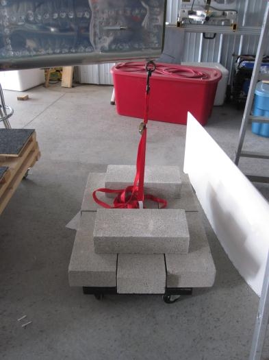

Here's a way without a lift......
This is just a few concrete blocks, 3/4" plywood bolted to a four wheel dolly. You can use a ratcheting tie down, or have somebody hold the tail down a bit while you adjust the tie down. It works quite well.....
don't you think that there is too much stress on the tail and its structures if you are pulling it down like this :cool: ?

In flight, the downward aerodynamic forces on the tail are at least as great as the static force applied here, I would think.
