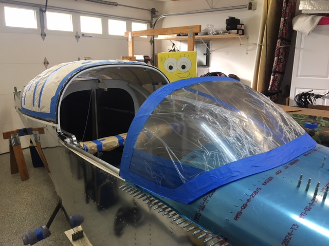

Today was a warm day, perfect for canopy work.
This weekend was all about cutting the canopy down to size. The on-line experts suggested to use the Dremel Max Saw. This worked out very well. However, they recommended the SM500 plastic blade, I found this to be a really coarse cut. I chose to use the SM510 metal blade. This blade is just like the cut off wheel Van's supplies in the kit, but for the Max Saw. With this blade, if the cuts are made carefully, there is very little clean up sanding. I took everything down to 240 grit after the cut, before moving the canopy.
The cutting wasn't as bad as others have made it out to be.It is only a (very expensive) piece of plastic. It isn't like it is a Ferrari or anything. Like everything else on this build, I was stressing over it and it turned out to be not worthy. With all the others writing of their experience, that background helped a lot. (Thank you)
I taped the canopy to the frame for a fit check using wire as a Sika spacer. Seems I have a few more trim cuts to make, so I figure another whole day in the sun and then it will be ready to bond.
I am thinking of not using the trim piece that sits on the outside, down the middle spine. It seems with the Sika bonding method, there is no need for this strip. But
I think I will need to bond on a thrust washer for the handle thou.

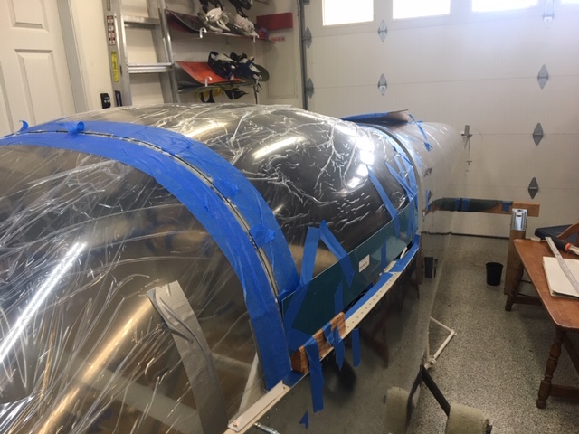

Canopy Part 3 Gluing
Got the canopy glued to the frame today. Used the sikaflex method as outlined by VAF’s Wirejock in an earlier post.
Like everything else the fear was worse than the event. Yes it was a mess, I think I got some of the black stuff in my hair because I have a grey spot that disappeared after I was done gluing.
I used tbe 3m fine line painters tape. This worked out well. I tried to add a layer of electrical tape on top like Wirejock recommended, but this wouldn’t stick. After prime I pulled off the 3m tape and then Re-taped with electrical tape to make it easier to make a fillet. This didnt work. It would have been better to just pull the 3m tape after prime and leave the primer’s edge untapped.
I set the frame upright, added a bead of sikaflex to the frame’s Spine, front and rear bows with the spacers, then dropped the canopy on top. After it was position and clamped, I added the side plywood to shape the sides and then added a bead between the side bows and canopy. I did not use the side canopy supports.
The canopy is clamped to the table so it wouldnt fall off The bench if bumped. Now I get to wait 48 hours in bliss thinking I did an excellent job. I am sure reality will set in after a few days when I unclamp and get a good look at the bonds.
