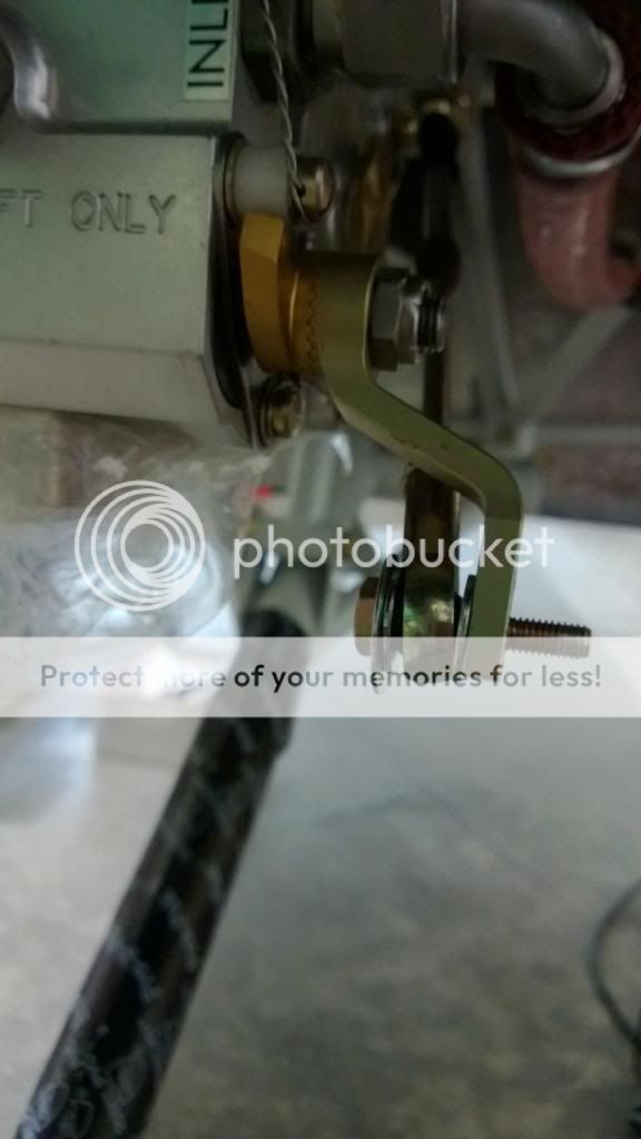

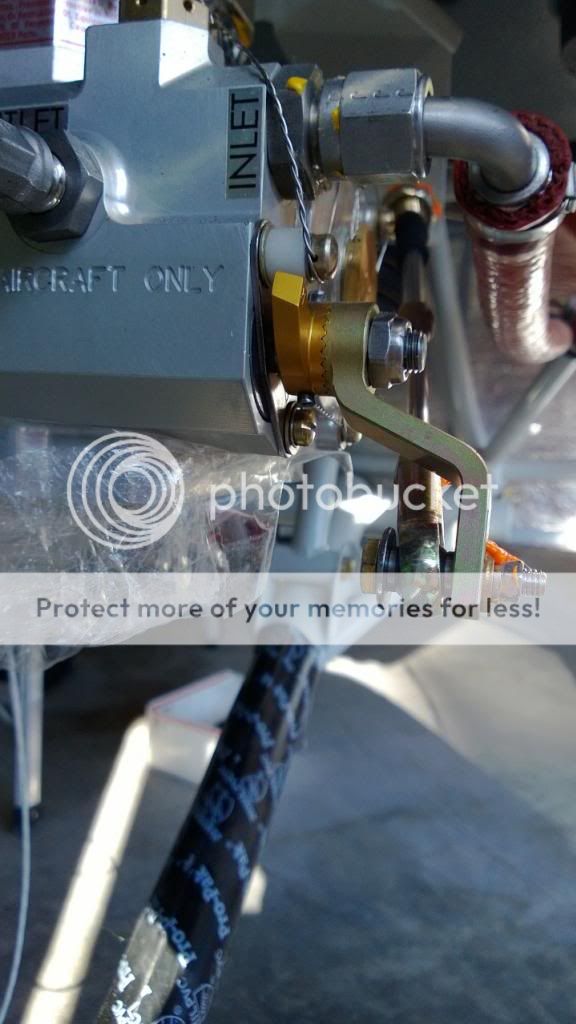

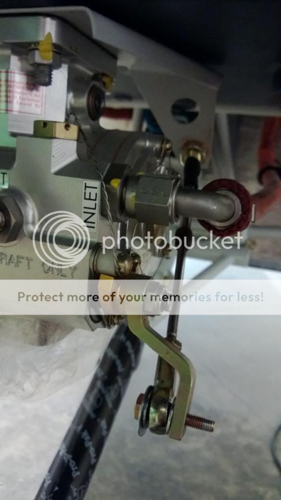

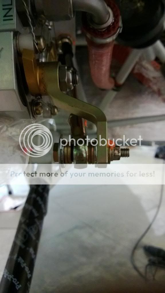

I've got a stock set up with the YIO-540 from Vans with the stock Fuel Servo. I just connected my push pull cable and secured it to the stock push/pull cable mount adapter between the servo and the engine sump. When I attempt to use the stock hardware (bolt, washers, etc..) the bearing is at a severe angle to the mixture arm. Once this is torqued down the rod end bearing is pinched into place and causes a great deal of friction. The only way I found to eliminate this friction was to use a longer bolt and add some AN960-10 washers that are in smaller diameter right up against the bearing surface. The larger safety washers are still there, just farther from the bearing.
Has anyone else had this issue? Other options to resolve this? The first two pictures are the stock hardware setup. The third is the configuration I used to eliminate the friction.

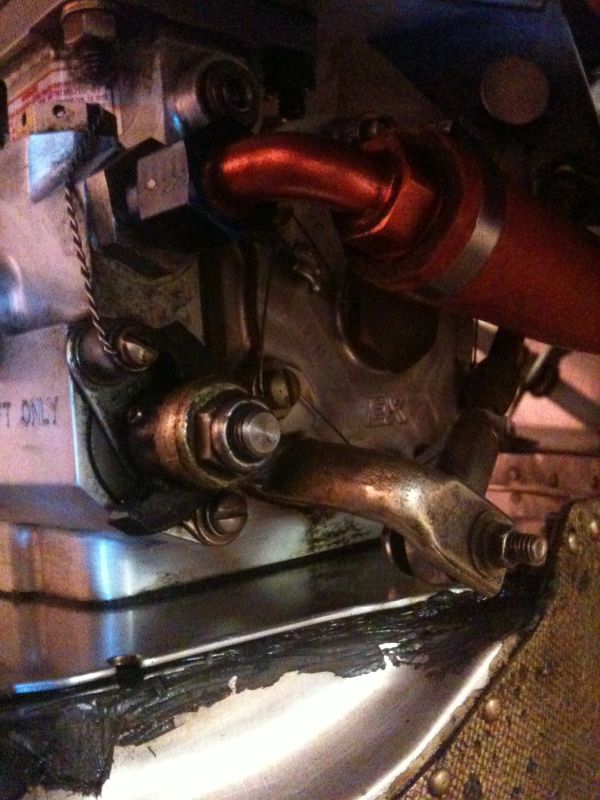

Looking at that setup gives me the heebeegeebies. And whats with the fuel supply line resting in contact with the exhaust collector? I don't care if its fire sleeved!
I'm gonna guess the fuel supply line was rearranged before the airplane started flying.
I spoke with Vans and it looks like I have the wrong washers on my assembly. There should be some much smaller O.D. washers on either side of the bearing. I picked some up and will try them. They look like they should allow the bearing to rotate much better at the angle I am seeing.
Also, I spoke to Vans and they were not aware of this alignment issue (big surprise?). They said they used a bendix FI as that was all that was available at the time so they haven't looked at the issue with the silverhawk.
Ok, the washers were the issue. I switched the washers out for much smaller OD washers. I had incorrectly put too large of washers next to the bearing and that was causing the friction due to the angle. I swapped them out for the right ones and now have full motion with no friction.
That was taking during the build process on Tim's plane. I think he has everything working okay since he now has over 900 hours in it.
Looked like a permanent install based on how the builder had fabricated a clamp on the air intake coupling that the fuel supply line was clamped to. May have been just a pic of a temporary mockup.
Don't believe everything you read. Many pictures on the site are taken DURING the build and that picture in no way represents how things were once assembled. I don't even know why that was introduced as some sort of "fix" for the problem. That's just a picture taken as things are getting routed.....and to imagine that someone would put a fuel line on the exhaust like that is just plain ridiculous.
