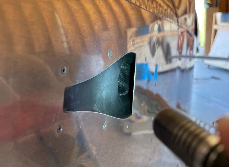

I have a bunch of leftover window screen material, so used some of that for the fuel vents and was figuring I'd also use it for other vents and openings. It's some sort of fiberglass. Anybody know what the longevity of that stuff is like? Just wondering if I should find something else a little more substantial, or if this will hold up ok.

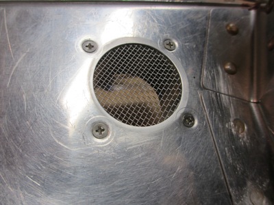

I'm sure it will survive quite a long time. I used a piece of stainless screen. I cut it just a hair bigger than the ID of the NACA tube. Push it in. It really grabs and stays put. The intake on the #1 baffle has a piece as well but it was just a square prosealed between the baffle and the vent flange.

This is exactly what I've done, secured with a zip tie. I had initially built with screens from a faucet aerator - which was a pain to secure. I had a few low fuel pressure events when flying with a full tank which I attributed to poor vent air flow, likely from excess proseal plugging the screen. I changed one side to the window screen and it worked so well I changed the other. I have 5 years with this and not a single issue. It has had fuel exposure a few times when I parked in the heated hangar with full tanks of cold fuel and leaked out the vents when the fuel expanded. In my experience, this solution couldn't be better.
Everyone is discussing fuel vents. Did you put a screen on the NACA vents and the intake side of the heater scat?
I folded a piece of screen material over the round part of the plastic vent scoops, prior to clamping on the scat tube. It's nearly invisible from outside the airplane and will hopefully keep bugs out:
For the heat inlet in the baffle I used a square of stainless screen:

I have a screen on the intake side of the heater scat, but not on the NACA vents - YET. didn’t think of that……. I had a yellow jacket along for the ride once. I think he buzzed in while I was taxiing, but didn’t see him until I was airborne. It wasn’t much fun having a passenger that can sting. I circled back and landed and when I got slow I slid the canopy open and he left the scene. I guess he (or she) didn’t like the ride either.
