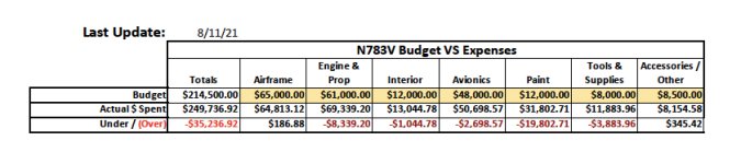

Here is a breakdown of my actual cost to build my RV-10. I kept meticulous financial records of the build and know EXACTLY how much it costs me. I didn't just track "the big stuff" (kits, engine, avionics,...) but also ALL the little stuff! That includes every piece of sandpaper, every tool, every oz of epoxy and primer, etc... If I bought anything that was needed for the build, it was tracked. It includes all the Aircraft Spruce shipping charges and all the runs to the aviation department at Home Depot.
As you can see, my budget was $214,500. My actual costs was $249,737. I did add many extras (Aerosport interior, custom seats, high end paint shop, etc...) but not as many extras as others (no ziptips, no ShowPlanes cowl, A/C, etc...) I am not frugal and tended to buy what I need when I need it. But I also didn't feel I went overboard with all one can do to a RV-10. A frugal person could probably do it cheaper than me (rebuilt or used engine, one screen VS two, no interior panels or overhead, etc...) but I do think this is a realistic number to plan on spending.
It took me 4 years (to the day) to complete my RV-10 (from 1st rivet to day I picked up plane from paint shop). I did slow build fuse and quick build wings. If doing it over, I'd do quick build fuse too. It added about 1 year. BTW, I am retired, so had lots of time on my hands.

Randy,
Thank you or the detailed information, and what a beautiful bird. I watched a few of your videos, including your in-flight situation. -yikes-
