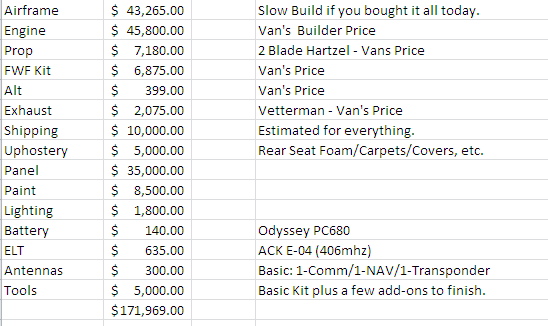

This is something that comes up quite often, so I've been maintaining a spreadsheet with current and past prices since last Nov.
I know I've missed some line items. You're never going to capture all of them even in your best efforts to identify all the costs. But this spreadsheet comes from Van's webstore and uses pricing that is available today.
There are a couple of things about this sheet.
1) I realize I'm painting with a broad brush, so I tried to capture factual pricing where I could and in those that are estimates (panel, upholstery, paint, etc.) I tried to find a conservative but reasonable number. Everyone's plane will be different.
2) I also chose the cheapest version of items to purchase (Experimental Engine, 2 Blade Hartzell, Cheapest ELT, etc). So this represents "the floor" from a new parts perspective.
3) These are today's prices and the prices aren't going down. So by the time the purchase dates for each of these line items roll around, you should expect to pay more.
4) The panel cost would get you a decent/modest IFR panel. I would add that it's 30-70% less than the total cost other RV-10 builders are spending on their panel. Most RV-10 builders I've spoken with are spending ~45K on the low end and ~100K on the high end. So this is still a very conservative number based on the actions of other RV-10 builders.
5) The upholstery cost is pretty conservative too, based on the pricing I've received to this point. But it's probably a good middle of the road estimate.
6) Painting, you can save good money here by painting yourself. I'm not doing it myself because I don't want to screw up a beautiful airplane at the 11th hour because I decided to get cheap at the last minute. This is a reasonable cost for a nice paint job, but not on the high-end either.
7) This doesn't include any 3rd party items. Geoff's carbon fiber panel, overhead console, center console, or interior panels (all nice stuff-btw), or Sean's door latch, or Andair fuel valves, or parking brakes, or rudder trim, or ______. You get the idea.
8) I know I've missed some big ticket items.
Being a real world RV-10 builder, I've learned a couple of things.
1) Whatever you think it will cost, it's wrong. Add $35-40K for price increases, items that you missed in your estimate, consumables, and scope creep.
2) If I were starting an RV-10 today and expected to go with a new engine, I don't think I'd count on anything less than $180K to get a basic IFR airplane in the air. Experience says likely you'll spend much more before you're done.
3) The final thing I've learned is that RV-10's aren't cheap compared to other RV's. They're cheap when compared to the cost of a new production airplane in its class. But when compared to 2 seat RV's they're just not cheap and can't really be built cheap.
I've found the RV-10 to break the rose-colored lenses worn by new builders when it comes to thinking you can build one at the lower end of the price spectrum. I think this applies to all RV's and not just RV-10's. But a miss of 25%-30% in the pricing estimate of a RV-10 is much more painful than 25%-30% pricing miss on an RV 7,8,9,or 12.
I guess the final-final thing I've learned is that real life gets in way of the most perfect and well thought-out plans. :mad:

Just to nit-pick a bit:
My memory is that the exhaust and alternator were included in Van's FWF kit price - unless that's changed.
I'm pretty proud of my panel (pictured in page 19 "Show me your panel"). It's basic but fully IFR capable, with IFR GPS, xm wx, an autopilot and independent, battery powered EFIS. It came in at $30K (2010 prices). I did all the labor.
OTOH, a few more "extras":
Sooner or later, you'll out-grow the garage, and have to pay for hangar space to finish. Depending on your location, that can be significant.
Do you want to insure against fire/theft? Especially if you're at a remote airport? Insure against a road accident on the move to the airport? When I was doing this builder's insurance was 1% of declared value.
Finally, this may not be part of the build, but if you use an XIO-540 or other non-certified engine and get a 40 hr fly-off, the cost of gas before you ever take a single passenger is not inconsequential. Nor is the cost of transition training.
That could be true, Bob.
According to the web store they are not included, but I can't say for sure as I'm not using their fwf kit.
