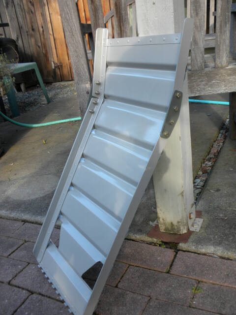

I have a long softie which I use in my glider, so naturally I want to use it in the RV-8 also. I found that the thickness of the parachute situates you closer to the instrument panel -- that is probably inevitable -- but it also made me feel like I was sitting too upright.
So, I made a second seat back that accommodates the parachute better. It is like a standard RV-8 seat back except that it has been modified to move most of the seat back farther aft. I think I posted a picture of it loooooong ago, but I may not have the link corrected to my current web host.
So, if you search on "improved comfort for aerobatics" my old thread will come up. Sadly yes the photo of the seatback is no longer visible. I added a comment to that old thread so it would re-surface here now, to make it easy for you to find.

I updated the URL to the photo of my modified seat back that helps with comfort with my long softie. It also helps to pack the chute "diaper down" to create a shape that is thicker down low and thinner at the shoulders, as Jerry mentioned in post #5.
[IMG]http://[/IMG]
+1 for Robert Marshall. He packs my chute.

Hi Steve, I had had a chute that was 3 1/2 inches thick. Pushed me so far forward, I sold it. Anyway, I like your idea here. Just to make sure I've got it right, with the bend in your backrest, you didn't have to move your roll bar it attaches to back, correct? The only thing changed in your 8 is this backrest??

Yes that is correct. The side rails are long enough to still rest on the cabin cross brace, with no other modification. I normally have a Aero Classics seat in the front, I just pull that one out and pop this one in.
