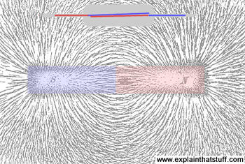

A magnet is much more effective at closing a reed switch if the magnet and reed switch
are mounted parallel with each other, NOT perpendicular as originally designed. The picture
below came from the following website which describes how magnetic reed switches work.
https://www.explainthatstuff.com/howreedswitcheswork.html
The north pole of the magnet needs to be at one end of the reed switch and
the south pole needs to be at the other end of the reed switch. Polarity does not matter.
In lieu of relocating the reed switch, a piece of steel can be installed to
concentrate and direct the magnetic lines of force from the bottom end of the
magnet to the far end of the reed switch.
