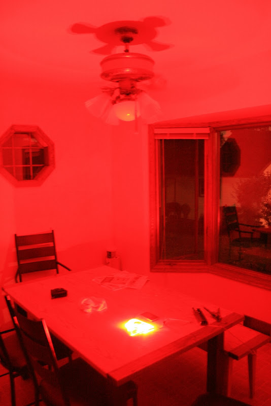

I've had a few requests for more pics, so here are some images Peter F captured today in his basement as we worked up what we are calling the Photon Bazooka(tm) for his -7.
This puppy will have two(waggable) 50 watt HID per tip and 4 Luxeon III stars for position. Several LED strobe candidates are currently being auditioned.
Here is the back of the LEDs with wiring
Peter metered on the LED die to keep the lights from blowing out the pic here. These are being driven at less than 200ma - 1/4 of full current. See the nice edge glow.....
Glamour pic of yours truly holding the power wires....hide this from your wives.:D You get a sense of how obnoxiously bright these things are even running at a fraction of capacity.

Pete, you should warn those that build these led light systems to put on sunglasses when they first fire 'em up! I'm still seeing spots......:p
Man these things are bright!
