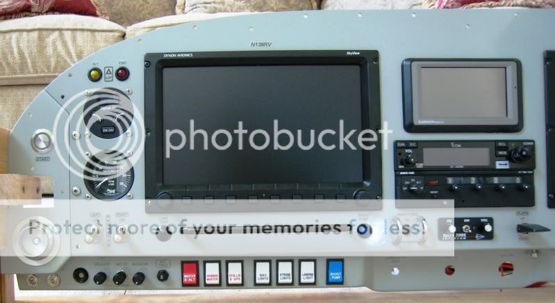

momentary toggle start
toggle Mag switches.
I did put a red cover over the start toggle. I went to hit the boost pump and got the starter.

Push button starter and locking toggle switches for mags. Also installed a "secret switch" which, when closed, removes power from the starter circuit. Yes, that's the security system! Not difficult to install - done by Aerotronics.

Push button starter with locking toggles. I also did some of that secret stuff.

I have a keyswitch and a push-button starter (plus left and right mag toggles, everything wired up to ground the non-impulse-coupled mag on start and all that).
No key in and turned to ON, no way to turn the engine over and clock someone.
I'm not concerned with theft...I'm worried about people who don't know any better at airshows, other fields, etc.
There was a story (I can't find it) from someone here who came back to his airplane at a fly-in to find some lady had put her kid in the pilot's seat, and he was happily spinning knobs and pushing buttons.
Why all the "hidden" switches and such? Just put a keyswitch. (My starter button is also illuminated if and only if the keyswitch is "on", thus providing another level of confidence in the safety of the system).
ETA: AND, the left mag (the impulse-coupled one) cannot go "hot" unless the keyswitch is on, so the prop can't turn over in the case of an accidental L mag switch on and some goober at an airshow hanging on the prop.
The worst failure mode I have is that the switch fails and I can't start the plane. It is Fail-Safe in that mode, Fail-Operational after starting.
