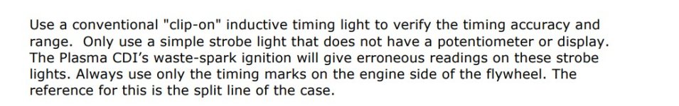

Electronic ignitions for the most part are set to TDC and the computer sets the timing. It needs to be confirmed with a timing light and the motor running at about 700 RPM. Usually this will take two people and one of them will be very close to a spinning prop standing on a box leaning over the motor with a timing light in one hand looking down the center of the case and trying to see a timing mark on the back of the flywheel.
The baffle behind the flywheel will also need to be removed to do this. And for any kind of accuracy, you will need to make a pointer that lines up with the case split and comes very close to the flywheel.

Tape a 12" drill bit along the top crank case split, extended thru a hole in the forward baffle so it was within 1/8" of flywheel. Made timing mark very prominent by using white & black vinyl tape on the appropriate spot on the flywheel. Used a STABLE platform to stand on over the engine. Use a 'dumb' timing light (plain version without dwell adjustment). Cautiously time engine...
