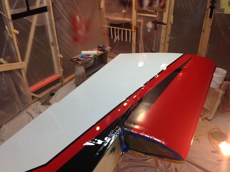

Rosie?s post about the 30th Anniversary of the RV-6 event at OSH struck a nerve and I knew it was time to tuck my 6 back in the hangar for a few OSH improvements. I fly a fair amount of IFR and rain is like sand paper at 200 mph. A new coat of paint was in order. This also provided me a chance to make a few improvements. Although I liked my original paint scheme I wanted to spice it up a bit. Some type of checker board was the answer. Steve Melton?s posts on his paint project encouraged me to take on the painting project myself. Although I had repainted the wheel pants and cowling over the years this was my first attempt to paint the entire plane unassisted. Using a PPG base coat / clear coat system made the process longer but much easier in my mind. It also made more complicated designs possible with my skill level. Unfortunately I could not fit the entire plane in the booth.
Masking the tail?s new checker board pattern
After the clear coat was applied
After clearing the first wing

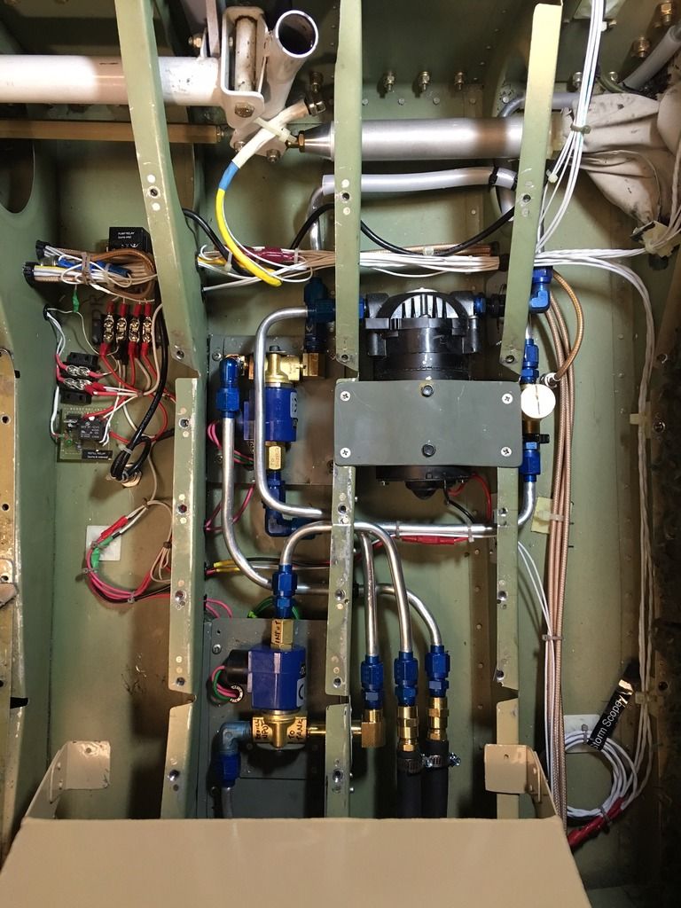

Although I was an early member of the Team RV formation team I never added smoke to my -6. This was the perfect opportunity. There are several nice smoke kits listed in VAF but I didn?t want to risk getting smoke oil in the cockpit. I decided to work with Marvin Homsley (http://www.smoke-system-helper.com/) to modify his very clean ?hidden RV6 tank?. Marvin kindly removed the filler neck and provided 3 threaded ports (Flop tube exit, refill port, and vent). In an effort to keep the installation as clean as possible I designed a ?one button? refill solution that would allow me to use the diaphragm pump to generate smoke as well as refill the tank. The pump and 2 solenoid valves were installed under the passenger seat.
pump / solenoid plumbing and electronic controls

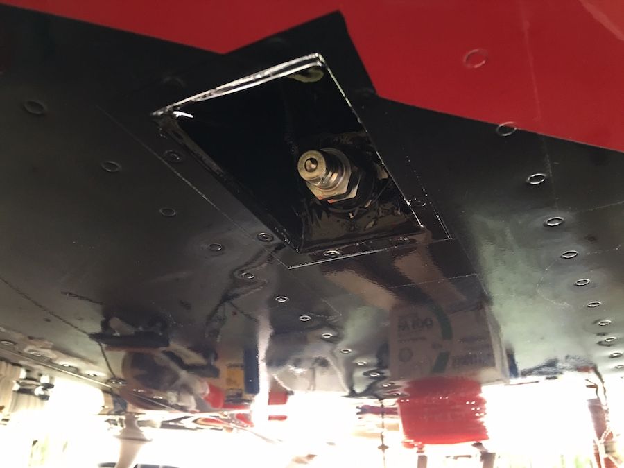

I also added a small recess in the belly to mount a spill proof disconnect (?oil stinger?) for easy refill. I simply connect the female disconnect hose and drop it in my smoke oil container. A hidden switch actives the pump and solenoid valves to pump oil from the smoke oil container into the on board tank. If I happen to pump too much oil it simply drains out the vent line near the refill ?stinger?.
Photo of the recessed oil refill quick connect port (stinger)

I like the smoke fill system! Neat, clean, and hidden.
Could we see a picture of the tank in position, and could you post the part numbers/source for the QD fittings and solenoid valves you used?

rmartingt, all of the smoke system items including the disconnects are available directly from Marvin at www.smoke-system-helper.com. Marvin is a great source of info. I found the 12V 1/4" 3 way solenoid valves at Valves4Projects on Ebay. I could not find many options for small 3 way valves. Given the tight space and extra weight from the valves I chose to plumb this with hard lines rather than the rubber hose that Marvin provides with his complete kits. That proved to be a challenging process. I'll post more pics for you. Since we're neighbors feel free to fly over to 6GA0 to see it. Greg
