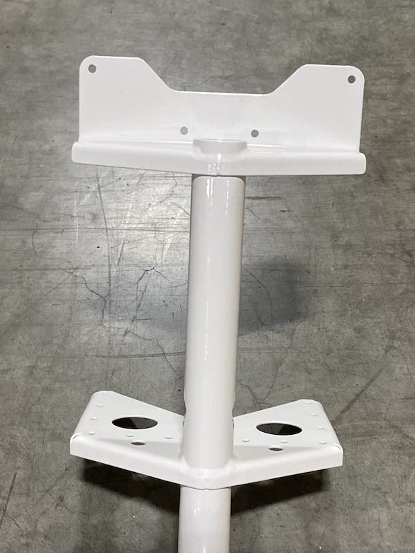

I would like to see a photo of the new gear leg to understand why the engine has to be more or less unhooked and lifted to replace the nose gear leg.
There must be some new metal that conflicts with existing stuff; the one on my original RV-12 was pretty much just bolted on with 13 AN bolts and from my memory should be a simple replacement..
Are there any photos of the new gear leg that would clarify this for me ?

The reason you'll need to unattached the lower engine mount bolts and lift away is that both the existing and new gear legs have a flange at the top which is "sandwiched" between the engine mount/isolators and the firewall. The lower engine mount bolts pass through all of these. You will need to remove those bolts in order to remove the existing gear leg, then back-drill matching holes in the new gear leg's flange from the cockpit side of the firewall. You "lift away" the engine mount to remove the elastomers and insert a temporary wood spacer to allow the required drilling. This is covered in greater detail in the SB text, of course.
When you originally installed the existing nose gear leg, there were full-size holes already in the leg's flange, and pilot holes in the firewall. The original gear leg was used as a drill guide. Now that you already have full-size holes in your firewall, the best method to ensure the new flange is properly drilled to match is to use the firewall holes and tools per the SB to match-drill the new gear leg flange.
Hope that helps. Here are photos of the retrofittable gear leg. Note that the two holes in the upper bracket/flange where the engine mount bolts will be located are not yet drilled - the installer completes that task via the match-drilling steps.

Thanks for the photos....I am at home and don't have the plans at hand, and had forgot about the "upper" part that gets squeezed at the engine mount, had vaguely recalled only the part that bolts to the bottom of the fuselage.
Thanks that cleared me up
