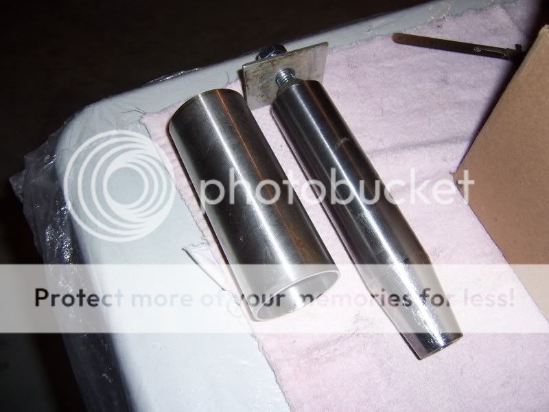

John Bender had this problem also. He invented a tapered pin that can be tightened up with a wrench to draw the wing skin into the seal.
Here is his post in another thread.
http://i568.photobucket.com/albums/ss124/JBender_photos/RV-12WingInstallPin100_1105.jpg
I had a local machine shop make this for me. Solid steel. Slightly under 1 1/2" diameter, with 2" taper from 1" to 1 1/2", then polished. 1/2" X 13 thread in both ends for pulling in from the rear, and pulling back out thru the front. Once it is pulled in, you can put in the other sides pin, and remove the special pin with the sleave and a bolt or threaded rod.

John Bender
Trusting my memory - WATCH OUT
The solid steel pin ( 6" OA length ) is just under 1 3/4" if I recall. The end is 1 1/4" tapered for 2". Both ends are center drilled and taped for 1/2" X 13 thread. You can use a bolt or threaded rod. The SS sleave is to put over the bushing in front to pull it back out. It is only maybe 5 thousandths less than the bushng bore. Once pulled thru the second bushing, the pin goes into the other side easily, then pull the tapered pin and install the second pin. I use it on the pilot side.

If it expands far enough it could work. Not sure if it would leave small marks inside. I'd guess not.
Went back to the start of this thread. The figures above SHOULD have said taper from 1" to 1 1/2". You'd need an expander with those dimensions. Sorry !

wing fit
regarding the wing fit against the seal, did you heat the seal enough to soften it. We recently installed a wing and had a heck of a time w/one of the wings, so we got out the ol' hair dryer (or heat gun) and gave it a little more heat. That and a bigger hammer, and the pin went right in.
Luggage straps
It's always cold in Scotland ;-)
As noted elsewhere, I am using luggage straps attached to the wing tie-down rings, to pull the wings together (with the seals in place). Works every time, no hammer needed.
Just make sure you screw in the rings as far as possible to minimise un-designed bending moments.
Cheers...Keith
