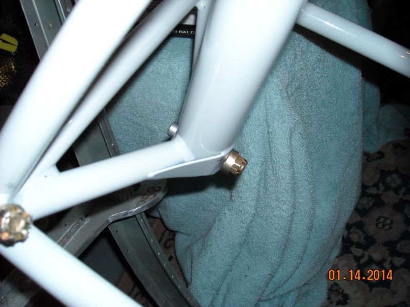

This is the only pic I have. Not much to see, just the finished pin installed.
