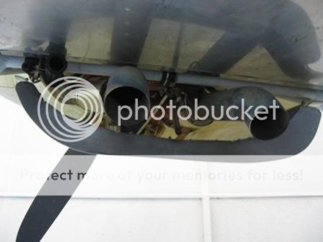

I had an almost identical problem with my Rocket. I am about 30 hrs into Phase 1, and any of the higher power settings caused a vibration. I tried duplicating the problem on the ground, and had the prop dynamically balanced. No luck.
I checked all the other usual culprits: floor boards, exhaust, loose engine hardware, etc. I finally took a very close look at the exhaust as it was exiting the cowling, and found witness marks that could have only been caused by the exhaust rubbing on the cowl. Since I couldn't duplicate the vib on the ground, I speculated it could be flow induced. Or possibly a sweet spot of flow and a mechanical resonance. And since I was also having cooling issues, I built a stiffener for the lower cowl that also included a diverter, much like you see on the Cessna amphibs. Took about 2hrs, and can be removed with three screws.
Vibration is now completely gone, and the cooling issues are gone (but no 90 OAT, either). The result was pretty dramatic. In fact, it is the difference in cooling performance that I am still scratching my head over.

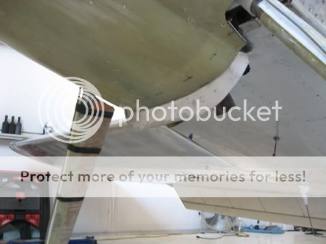

The assembly consists of a .040" aluminum strip on the lower cowl. But I wanted some out of plane stiffness as well, and decided to create the flow diverter as an experiment to see if I could also improve cooling. It's about an inch wide, and out of plane about 30 degrees.
Caution is in order here. Although I have eliminated the vibration and improved cooling, I haven't yet convinced myself that the diverter alone improved cooling. It may be that the vibration of the lower cowl was inhibiting exit air flow, and that a robust stiffener without the diverter would have been sufficient. More testing is in order.
