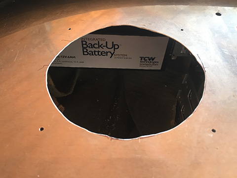

About a month ago I asked you guys how to fix the heating problem behind my panel. I took the advise and installed a couple of 4" fans.
DigiKey has a pretty incredible filtering tool on their website and I used it for selecting a couple of fans. I picked a low rpm fan as I didn't
want a lot of noise and they easily exceed the cfm that would be required to displace the air behind the panel. They also have a very large
supply of different style fan screens. My biggest challenge was installing these in a finished panel. What you don't see in the pictures is that
I removed my displays and put towels behind the panel to keep metal shavings from mucking up my avionics.

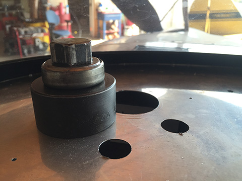

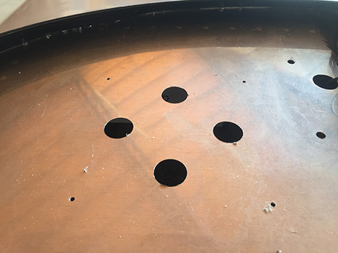

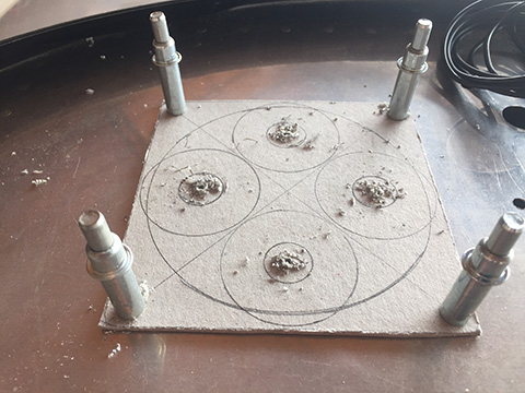

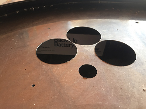

First I made a template out of a piece of fiber board that I purchased at Hobby Lobby. I cut out the exact size of the fan and then drilled the
holes for mounting the fan.

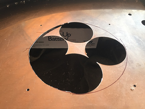

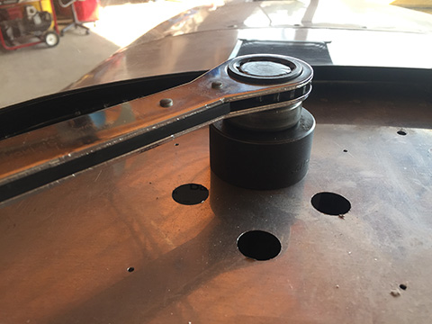

I used a 1.5" knock out punch for the holes:
At this point I cleaned up the circle and reduced the sharp edges. I also made sure my glare shield cover also had matching holes and then attached the screens glare shield and fans together.
The glare shield material is actually a form of velcro that is used on convention displays. It looks really nice and stuff will stick to it.

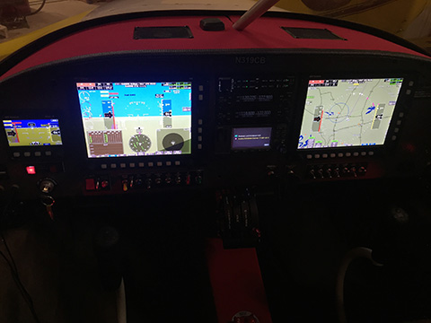

Results

Although the fans helped with the heat issue behind the panel, they just moved it to the cockpit. I need more air movement as it gets really hot here in Texas. Even at 12K it is pretty warm in the cockpit. Overall it is better for the electronics in the panel.
The fans come on with the master, but I also installed a switch so I can turn them off if I need to.

I cut small holes so reinforcement should not be needed and there is plenty of airflow.
Not sure...
why you didn't stop after the four 1.5" knockout punch holes were done. Seems like they would allow plenty of airflow and obviate any worries about needing a perimeter reinforcement ring. The amount of material you still had to remove to get a full-size circle cutout makes me wonder if the four inside tangent circles you punched really helped the process much, aside from a starting point for whatever tool you used to nibble away the remainder.
Just trying to learn. I will be doing the same, but before I install the forward skin and panel structure, avionics or windshield.
