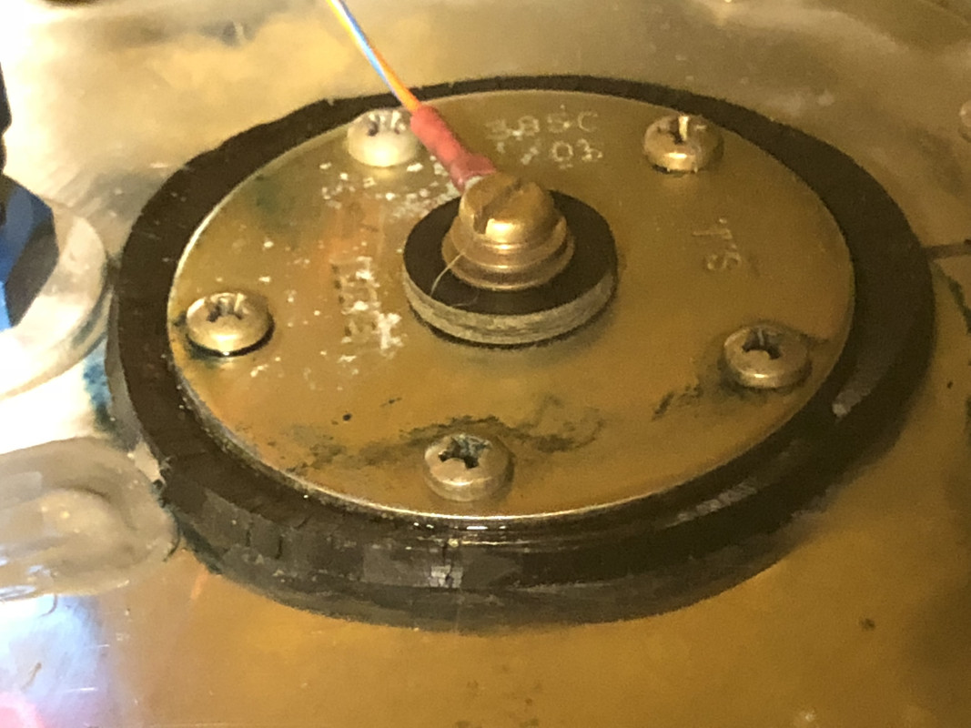

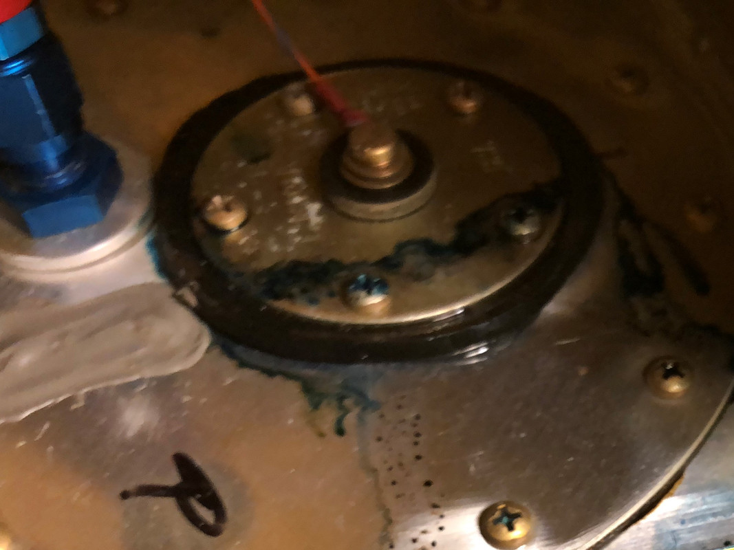

Anyone have suggestions as to where or how I can efficiently fix or replace the black rubber gasket where my fuel metering is coming from? I wonder how long these gaskets are expected to last. I have pictures I took this morning, but I don't know how to attach it.

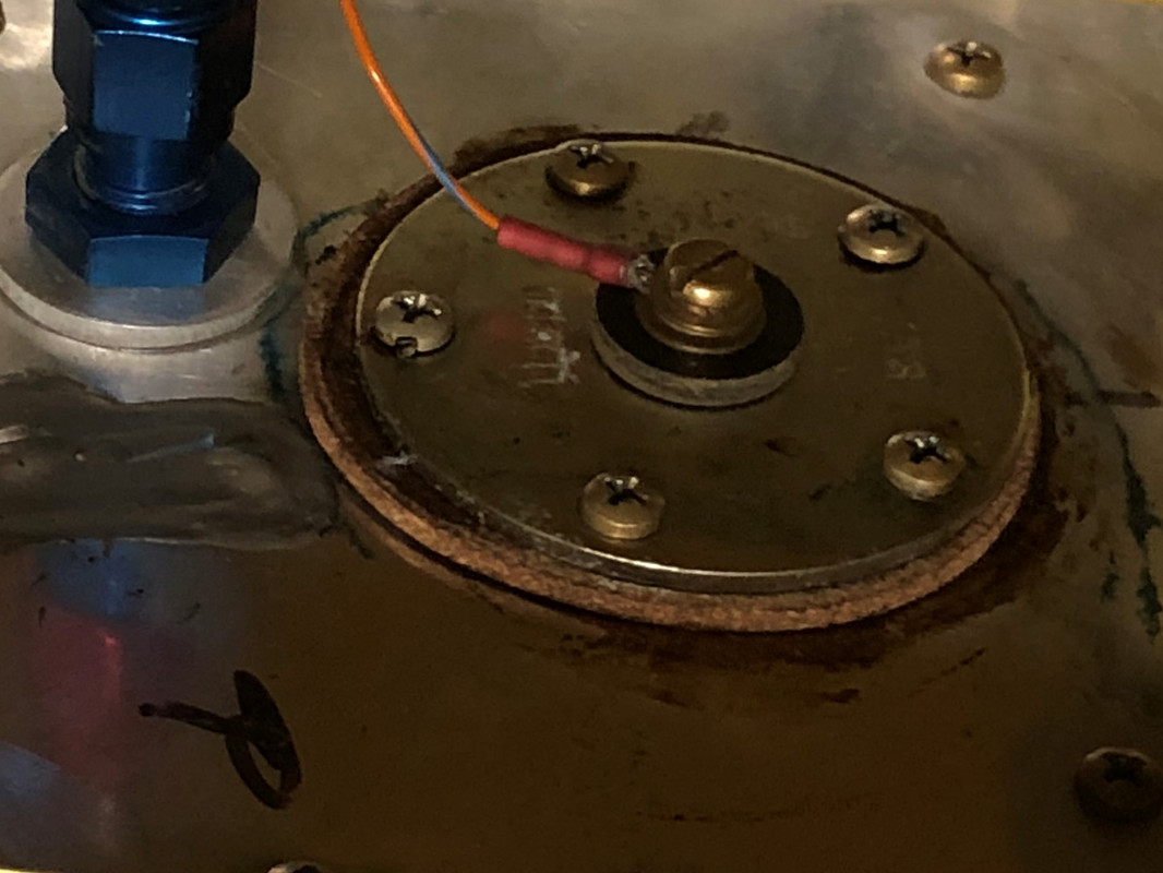

I purchased a 2015 RV8 in 2017, and had to replace the rubber gaskets in April of 2018. I replaced them with cork and some Permatex 80019 Aviation Form-A-Gasket. I've used Permatex 80019 for nearly 40 years on lots of motorcycles(an old Greeves that was a chronic leaker) and cars and it's never let me down. Great stuff. I pumped the tanks out, removed the wing root fairing, removed the sender, cleaned all the pro-seal off the area (being very careful not to get any in the tank) and put it all back together with the cork gasket and a thin film of 80019. Took and evening to do both tanks. Not a drop leaking since.
I'm pretty sure the instructions tell you to throw away the rubber gaskets. Not sure why the builder of my plane used them. If I can find a picture or two, I'll post them.

Edit: Adding photos
Over time the cork will eventually become saturated with fuel and leak again.
The permanent solution is to remove all gaskets, clean thoroughly and reinstall using only pro-seal.

Bummer. I thought I read somewhere that cork was the solution and that's what my A&P suggested. Two conditional inspections and everything looked dry. When should I expect them to leak again?

The next time it leaks, ditch the gaskets (rubber or cork) and just seal things with proseal. It will still removable, and will have a much lower probability of springing a leak.
Maximum longevity I've seen for the cork gaskets is around 5-7 years.

As another data point: When I built my 8, I used the cork. At my last annual (December) I noted that the right wing was leaking at that area. I pulled the cover, removed the cork gasket, and used pro seal at the union and screws. Since it was cold, it took a while for the pro seal to cure...I ended up covering the wing/fuselage with a moving blanket and putting a shop light under it for warmth. After a couple weeks I refilled the tank and all is well. I will probably preemptively do the same thing to the left wing this summer when it is a little warmer. The task wasn?t that difficult...couple of hours work.
Cork baskets will work fine in this application - for a while, maybe a little longer if you schmooze it over with permatex, but it will leak eventually. Same with cork rocker box covers - eventually. Vans doesn?t even recommend using those rubber gaskets on the fuel tanks. While nothing is permanent (forever), proseal is the best way to go. It will probably outlast your ownership.

Yes. The permatex will provide a good seal between the gasket and the surface. However, it doesn't help with the overall deterioration of rubber and/or cork material. When that happens, the leak is directly through the seal itself. These are thick gaskets with a substantial unsealed side.

Another very good, long term, solution that doesn't involve Pro-Seal is a flat Buna-N gasket (as opposed to natural rubber, Buna-N resists ethanol and 100LL) coated on both sides with Hylomar Blue or Permatex 85420 - comparable products and both are readily available and inexpensive (Amazon...). Unlike most gasket sealants, Hylomar Blue cannot be removed with alcohol, so resists all engine fuels, even ethanol.
An excellent sealant that can be removed later and cleaned up with MEK (if you can still get it) or acetone.
If you can't find a flat gasket already sized for your application, you can always buy a sheet of it (I recommend 1/16" for fuel senders) and cut your own.
The pro-sealed senders can be removed by working a sharp putty knife into the joint. There really isn't a downside to using pro-seal.
