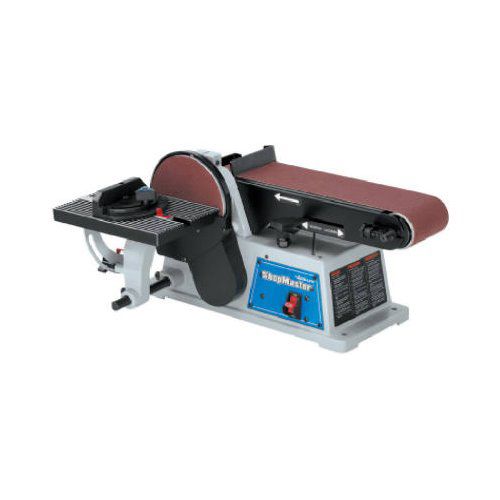

To clean up the cut marks, I have one of these Delta bench sanders with 80 grit on the disk and 120 grit on the belt. After dressing my cuts on this, I finish them on the deburring wheel spun by my drill press set to the lowest speed.
