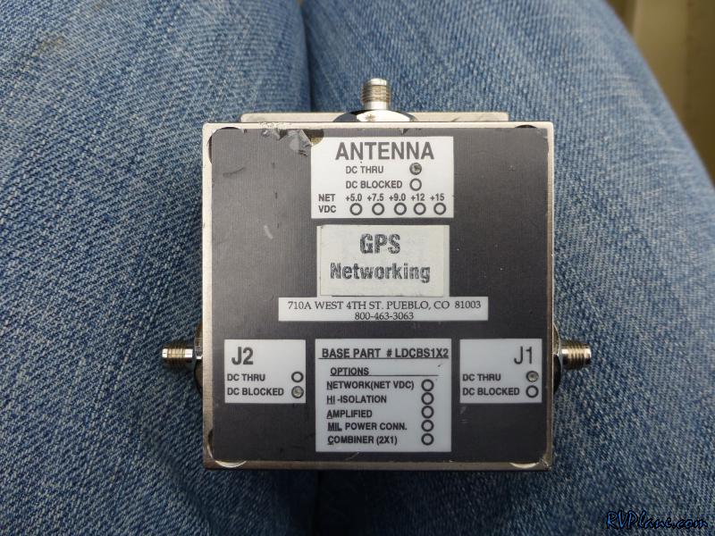

I found a few GPS splitters on the market. They are all in the $300 range and all pass DC voltage from one receiver to the antenna and block DC voltage from the other receiver. They also place a dummy load in the blocked line to fake the blocked receiver into thinking its seeing a valid antenna. The question of course is if both devices are looking for the same amplified signal coming back down that coax! More research required!

Hi Randy,
I used one of the GPS Splitters (GPS Networking LDCBS1X2) to split a Gilsson GPS antenna (MCX1M09B090-AWMG) between my Navworx ADS600-EXP ADS-B Transceiver and my Garmin GDL-39 ADS-B receiver. While another GPS antenna was cheaper than the GPS splitter, I didn't have free room for yet another antenna (I already have 3). My setup has worked flawlessly for the past year. I purchased the splitter on Ebay for under $100
I think splitting the GA-56 non-WAAS antenna would probably work for you just fine. While I am not an antenna expert, the specs on the WAAS and non-WAAS antennas from Garmin are nearly identical in terms of frequency range, gain, noise, etc.

Yes, there might be splitters and things available, but the bottom line remains the same - it is extremely inadvisable to try to get very sensitive (not to mention expensive) GPS receivers to all work through a single antenna.
The DC power that's fed up the center of the coax in the Garmin and others is used to power pre-amplifiers in the antenna. The GPS signal from the satellites is tiny tiny tiny. The pre-amplifier boosts the signal to a level which allows us to use a few feet of reasonably small coax cable to install the antenna in our aircraft. Without the pre-amplifiers in the antennas we'd be allowed about three feet of coax the size of a sink drain to connect the receiver to the antenna. Each antenna has a specific amount of amplification, or "gain" to match the input signal requirements specific to each GPS receiver. Some want 30dB of gain in the antenna, some want 24dB of gain, some want only 10dB of gain. What's good for one GPS receiver isn't good for another.
At the end of the day, what are you saving by splitting antennas? Not much. What are you risking by splitting GPS antennas? Lots. It's just not worth it, IF it's feasible at all. And you will only know if it's feasible after you've spent $300 on a splitter and found it doesn't work.
Again, I apologize for sounding so negative, but the facts are the facts. Your best solution for an aviation application using disparate GPS receivers is to use the manufacturer's recommended antenna and coax for each receiver.
