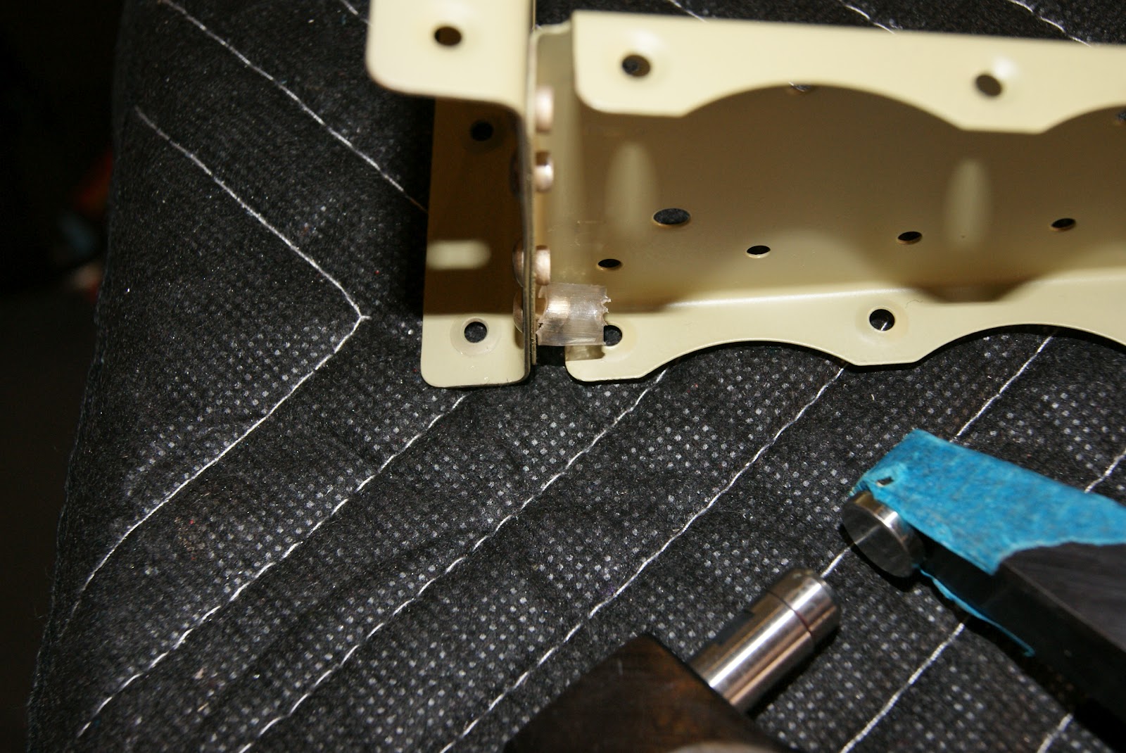

So I am working on the empennage kit, specifically in the tail cone section and trying to get these rivets right and no matter what I do it appears that I am forcing the rivet to expand in between the sheets of metal being riveted.
It isn't more then a 16th of an inch, more like a 32nd. I have tried drilling them out and using a vice grip to hold the metal together without much luck.

See the attached photos -
Side view:
Top View:

I had the same issue visit me at the beginning. When I made a point of always installing the rivets with the manufactured head on the side of the thinnest material, the problem went away.

Xoverzero has it right...manufactured head on thinnest part will help a lot.

Cleco everything up and adjust rivet squeezer to fit and take your time. Support your work while squeezing.
You did not say if you ensured that the parts were firmly pressed together before the riveting. The photos don't give a clear rendering. I have been bitten a couple of times by thinking the clecos had sufficient clamping forces. I have a few of those screw/clamp clecos for additional clamping force. I have a few pair of c-frame vice grips too to help with this.

The method I use to get parts to fit tight is:
Insert rivet
Place a piece of Tygon tubing over the straight section of the rivet about twice as long as the rivet sticking through.
When you squeeze the rivet, the tubing will squeeze the parts tight before the tool starts to set the rivet.
This saves a lot of time when doing thin parts.

RFSchaller is correct in that, structurally the direction of the rivet does not matter.
BUT, John is more on point. Put the manufactured head on the thinner material.
Because, as I understand it:
When the rivet is squeesed or driven, its shaft radially expands to fill the bore of the hole. This radial expansion is rather strong.
The force of the radial expansion for a dash 4 rivet (1/8inch) can easily pucker thinner alumin sheet. This pucker can, and in your case is, separating the parts.
Placing the manufactured head on the thinner sheet reduces the pucker.
Additionally, the pucker can also be reduced by not setting, that is over setting, the rivets so strongly.
Don't ask me how I found this out. I deny ever doing what you have described.

General technique is manufactured head on thinner metal. For one thing, you are more likely to mess up the piece of metal under the manufactured head if you need to remove the rivet and the thinner piece is often the easier and cheaper to replace ( don't ask how I know so much about removing rivets ).

If the two pieces are held solidly together (no gaps) and you press firmly down on the manufactured head (use gravity) continuously while squeezing there should not be a gap when you are done.

If you place a small piece of vinyl tubing cut slightly longer than the rivet over the shaft of the rivet it compresses the parts tightly while squeezing the rivet and makes for a tight joint. The tubing can be obtained at most any big box or small hardware store.
As others have mentioned, first choice (if possible) is to place the factory head of the rivet on the thinner material being riveted. Unless the plans specifically say otherwise, this is a good practice to follow.
Apply a slight pressure to the head of the rivet while squeezing it to help keep it flush to the surface being riveted as the rivet begins set.

Turning rivet around resolved immediate issue
So I went ahead and turned the rivet around (putting the manufactured head on the thinner metal) and it worked perfectly!
