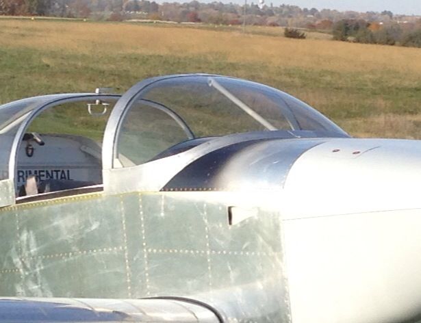

I have noticed on several finished and flying RV's that the glassed fairing at the base of the windscreens is cracking. My Cessna has a strip of aluminum to fair the base of the windscreen. I was just wondering if anyone out there has tried any alternatives to "glassing" the windscreen fairing to the windscreen? If so, any pics? Likewise, are there any known ways to prevent the cracks from occurring?
The last RV I saw had a beautiful paint job and now cracks are forming at the base of the windscreen. I just want to put some thought into this as I am just about to start cutting the canopy.

I had similar cracks. In my case it appeared to be a result of using Poly Fibre Super Fil from Aircraft Spruce. It has all shrunk. Fortunately I didn't paint yet, but I would stay away from that product. It would be interesting to know if others with cracks also used it.

A few have done aluminum windscreen fairings, overall I thought they took less time than finishing the glasswork. Google "RV aluminum windscreen fairings," there is a good article in an old RVAitor about how to make them.

I did aluminum. Worked out good. I'll try to find some pictures.

Looks nice, Crabandy! Did you use an English Wheel to do any forming?

Did you note the orientation of the cracks?

I chose to do all metal. I used an English Wheel to form them. I made the upper bow out of .040 for additional support when folks inadvertently brace themselves on it getting in and out.
I tried to avoid glass to metal joints on my airplane. If it is a plastic part, like a tip, there is a joint. Properly done fiberglass windscreen fairings look great and will stand up well. I still prefer to see the joint and if I was doing them in glass, I would make them a removable part, or have that appearance.

The cracks I have seen were lateral across the fuselage running parallel to front edge of the windscreen.
