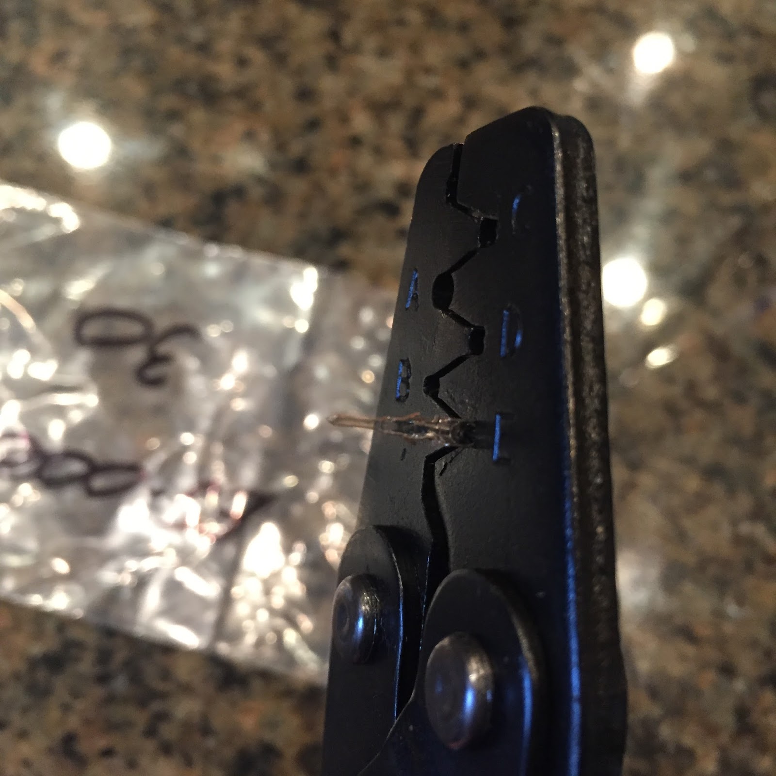

Ive been unhappy with my ratchet crimper results on these tiny molex micro-fit male terminals for the 6 position connector on the trim servo.
Can anyone recommend a good product that works well to get this task done ?

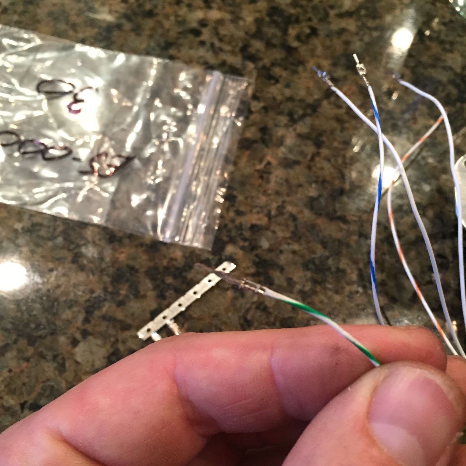

I took the advice I found in this forum and bought the SAT-018 crimpers from SteinAir. To create really solid crimps, I first crimped the micro-fit connector onto the insulated wire end.
Then I pushed the wires into the connector, ensured they were seated properly and crimped the wires down. honestly with the SAT-018 crimpers and this really went smoothly and you get a very nice crimp.
