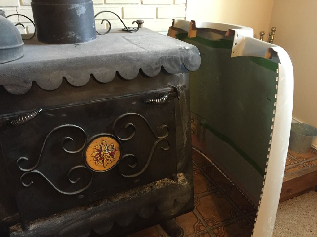

More destruction, man I was so proud of those ramps. I used foam/glass to continue the spinner curve of the cowling onto inlet ramps so the black baffle material had a nice smooth transition to push against. I didn't have the heart to throw them away...
The top cowling is cleaned up and block sanded, I never smoothed the surface originally and just roughed it up and covered it with epoxy. I'm thinking of using the top cowling as a mold for making a plenum but it's going to take some work first. I would rather build the plenum over the existing baffling, but I can work with the top cowling at home in a semi-heated garage (and in the house next to the woodstove when the wife is at work!). Here's a pic before the first thin coat of filler/micro.

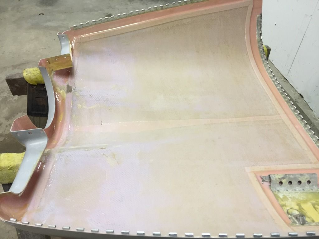

I figured the inside of the cowling would be a good test bed for trying drywall mud as a pinhole filler, I figure the extra heat should help expose anything and if it does the areas will be under the cowling. The inside of the cowling was coated with raw epoxy but never properly block sanded, I added a thin coat of filler and sanded smooth. I then spread drywall mud on with a rubber scraper, I added a second coat later just smooshing it around the surface with my hands. As expected it sanded of very easily, it seemed to fill the little scratches, small and large pinholes well.
I carefully cleaned it up and squeegeed on a coat of epoxy primer. I wet/block sanded this and then sprayed a coat of epoxy primer that I also wet sanded.

I buffed on a layer of wax, and a couple coats of PVA. This was my first time using PVA and I sprayed my first coat on too heavy, I had some runs and drops on the vertical surfaces. I used AEROPOXY and laid up 4 layers of 9oz glass, so far this is one of my better fiberglass pieces. I covered the layup in peel ply and topped it off with scrap glass to soak up any extra resin,l. I tried really hard to squeeze out all the extra epoxy and air bubbles while it was between sheets of plastic before I applied the epoxy infused glass to the cowling.
It half cured in the garage at 65-70 last night .I'm trying for a 110* cure with my wood stove and instant read thermometer.
