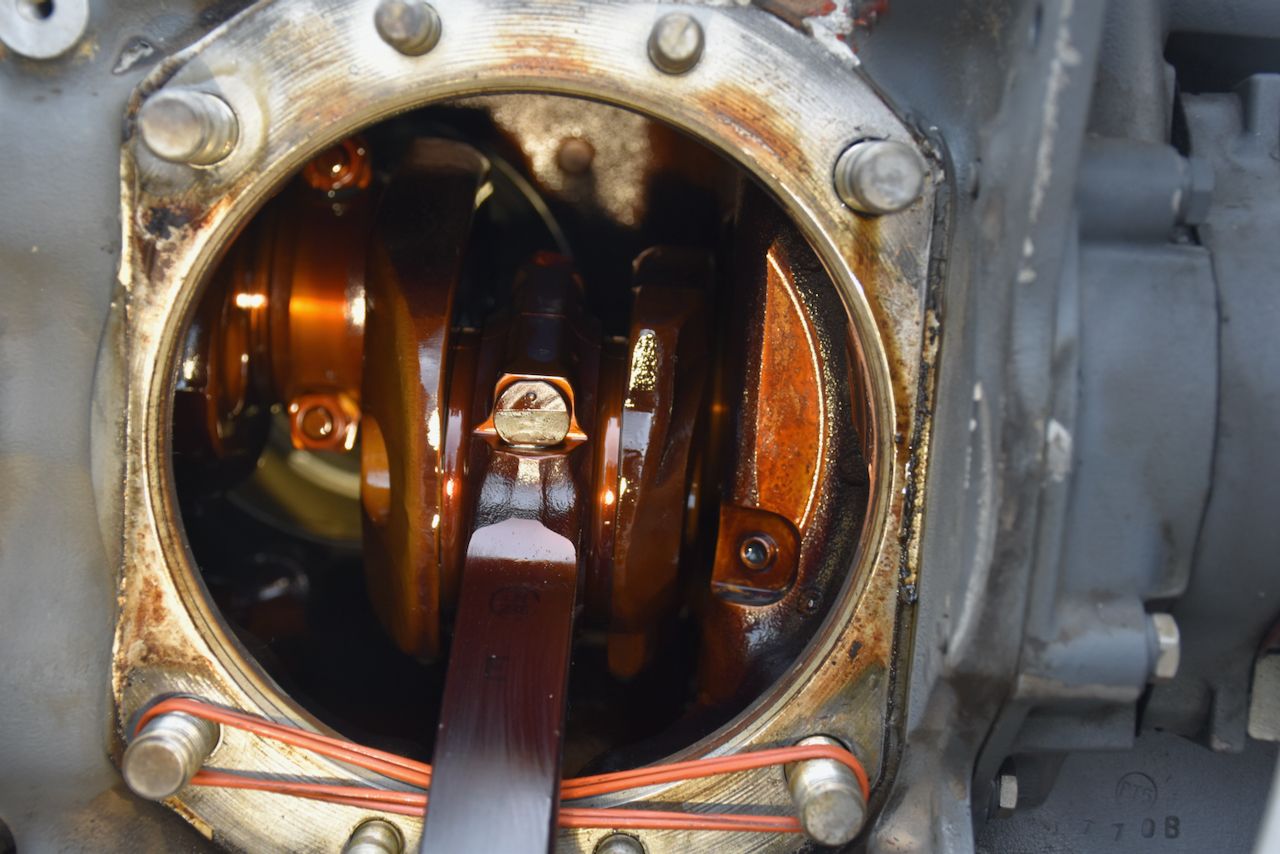

I pulled a jug off my 360 angle valve and just for kicks thought I would get, if possible from photos, input on the condition and repairability of the cylinder.
This is super subjective I understand that but is anything glaringly discernable from these shots?
Thanks!

One thing is noticable...there seems to be no crosshatch still visible in the swept surface. You can see the crosshatch in the area below the piston travel. I would guess oil consumption might not be so great.

Since you have the cylinder off be sure to look at the cam lobes and better yet stick a borescope in there and take pictures. Since it's impossible to check for pitting / spalling with cylinders on.
The rings are wiped out. A serviceable ring will have a bit of varnish all the way around, covering about 1/3 give or take of the ring top to bottom. The shiny part is the portion of the face in contact, the varnished half is the future wear surface. If it is shiny top to bottom; across the entire face, they are shot and will use oil and have lowering compression.
Valves looking good. Large area of ancient corrosion, question is how deep it is.
Slightly puzzled by the blue spot visible on the bottom of the pictures... overheat of some kind?

I think the blue spot is a reflection of the spark plug hole….
Howdy Everyone. In the first picture; it appears that there may have been some sort of gasket material or sealant between the cylinder base flange and engine block pad. (where the studs are located for cylinder mounting) That is a no-no; only an O ring should be used for the seal.

Kent, don't worry about it. Do a complete teardown. Send all the major components off to the inspection/rebuild shops, and order everything on Lycoming's replace-at-overhaul list.
New cylinders are worth the money. I would not install rebuilds if I had a choice. Cylinder head cracks and joint failures are mostly a function of stress cycles. Rebuilds don't turn back that particular clock.
Yes, I'm suggesting money saved at this point is false economy. Pulling the engine at some future point is, at a minimum, a huge PITA, and if you sell the airplane before then, you'll get less money. It's out and on the bench, so just build it to new spec and be happy long term.

1. This is an early wide deck IO-360, not a narrow deck.
2. Rings can wear to have full contact and be fine. You're gonna replace them anyways.
3. These are low time cylinders since last overhaul with little to no deposits.
4. Cylinders are lightly pitted and are glazed from what I can tell from the pics.
5. Overhauled cylinders are fine, especially angle valve, due to cost. New cylinders are unobtanium right now so your choices are limited.
