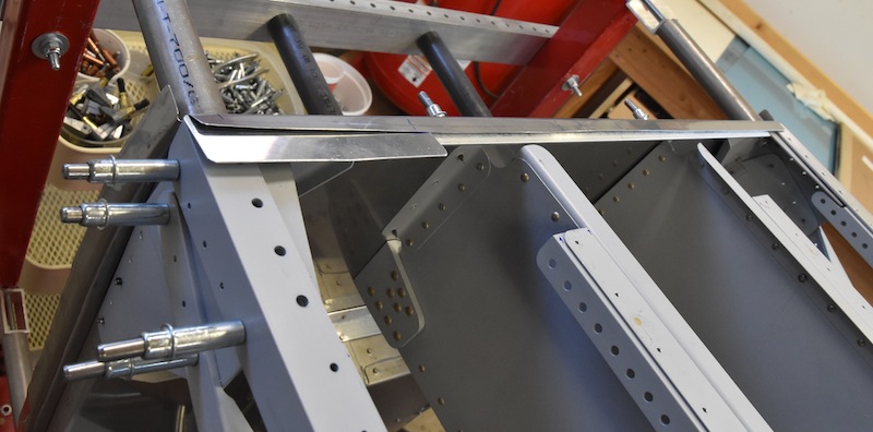

Default Flaps - FL-303
This is a follow-up to post #2 in this thread.
A couple of years ago I recommended moving the flap inboard
rib closer to the fuselage by 7/8" to improve the linkage geometry.
This was based on careful measurements of Randy Lervold's machine.
Recently I was finally able to assemble my fuselage, wing, flap,
linkage, and fairing. To my relief it all fit just right!
The photo below shows the control linkage almost vertical, with plenty
of clearance with the F354 fairing. Also note the stiffeners and
rubber channel applied to the flap bottom skin to help it fair
smoothly to the fuselage tailcone when the flaps are retracted.
This yet another area that is a bit more complex than indicated by the plans .
