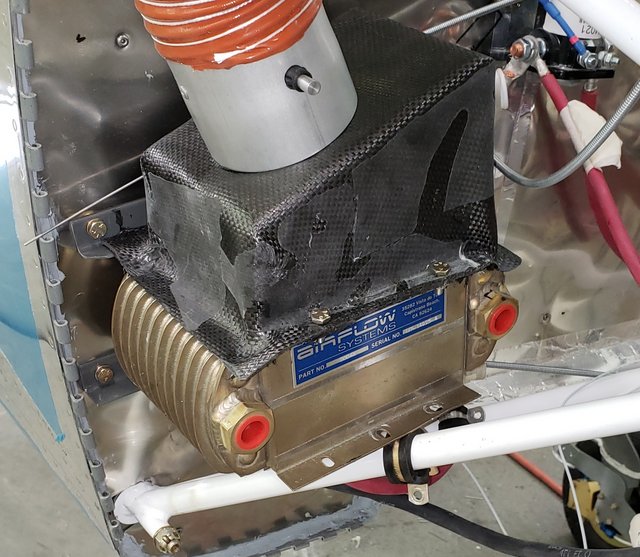

Originally Posted by PilotjohnS View Post
Carl,
I do like it better on the mount, away from the exhaust headers (but it is in the oil cooler outlet flow).
Do you think there is enough length for the engine SHAKES?
Regardless of where I choose to mount the sender,I will need new lines. This means 2 of the 4 fuel lines that were part of the Vans firewall forward kit will need to be changed. ugh
For my install the oil cooler is firewall mounted on the other side of the engine (see photo). But, compared to exhaust heat I'd suspect a baffle mounted cooler would not be an issue.
This mounting location is on the fuselage side of the engine, so engine vibration is much reduced (the reason for not mounting it on the engine).
Hoses are easy to make. Just buy the parts from Van's. I have never used the Van's Firewall Forward kit so can't comment on that.
Carl
