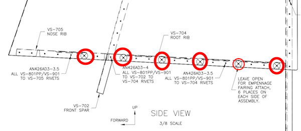

When referencing the rivet call out on plans page 28 be sure to check page 44 for the screw call out. There are nine locations under the horizontal stabilizer that will be tapped for screws to attach the lower tail fairing. On page 28 it shows rivets in those locations.

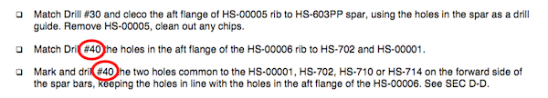

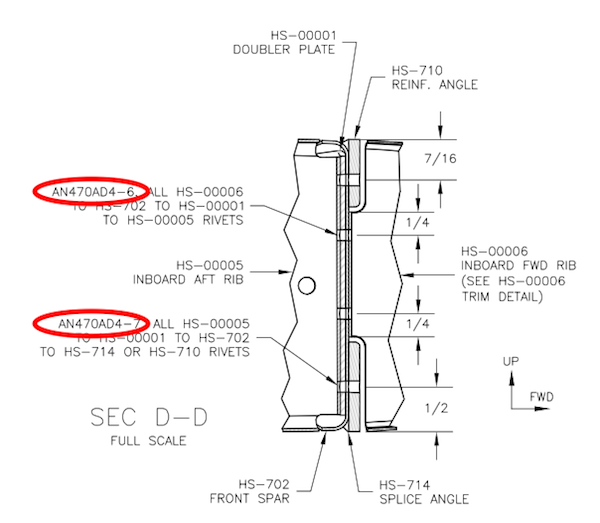

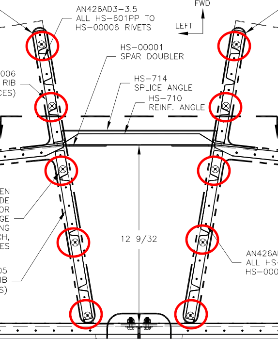

Default Horizontal Stabilizer DWG 3
I wanted to document some of the issues I found with the revised manual pages for noobies. If this is your first component, I suggest building the Vertical Stab first. There are a few tricky spots on the HS.
1. Page 6-2. Drill a #30 relief hole in HS702.
I marked the location of the hole according to plans then placed the 702 spar on a 45 degree square and center punched with the punch held 90 degrees to the bench. This placed the mark exactly at the 1/2 radius bend line of the spar flange. From here it's easy to enlarge to 1/4" and trim the ends of the flange per plan.
There is also a trim on the ends of the spar flanges shown on the trim detail where the most inboard skin hole would be. This part can't be cut until you know where the second hole from the center on the spar flange will end up.
2. Bend the HS 710 and 714 angles
Mark the line, place in a vice between pieces of wood block. Measure the starting point with a protractor and bend carefully till the protractor reads 6 degrees. Creep up slowly. Remove it and check several times. Note HS714 is much harder to bend than HS710.
3. Notch the aft flange of HS00006.
Don't do it per plans. Place it between 710 and 714 and see how much needs to be cut. It's not much.
4. Prepare the ribs.
I recommend drawing center lines on the flanges of the ribs and the spars. They come in handy later.
5. Page 6-3. Match drill the holes in the skin to the HS00005 rib.
The manual then directs to clamp parts together to drill flange to spar holes. I would not drill skin holes till all structural holes are drilled and clekoed tight.
As usual YMMV.
