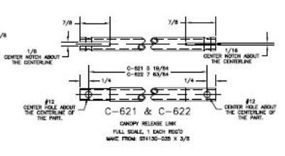

Default Tip Up Canopy release mechanism: C-621 and C-622
When building the Tip Up Canopy Release mechanism be careful at the C-621 and C-622 dimensions on drawing 47:
The length of both parts are shown between the holes and is not the total length as is usually the case elsewhere on the plans.
If you make these dimensions the total length you will end up 1 inch short.
Don't ask me how I know... It seems I'm not the only one to have done this mistake.
Alain.
