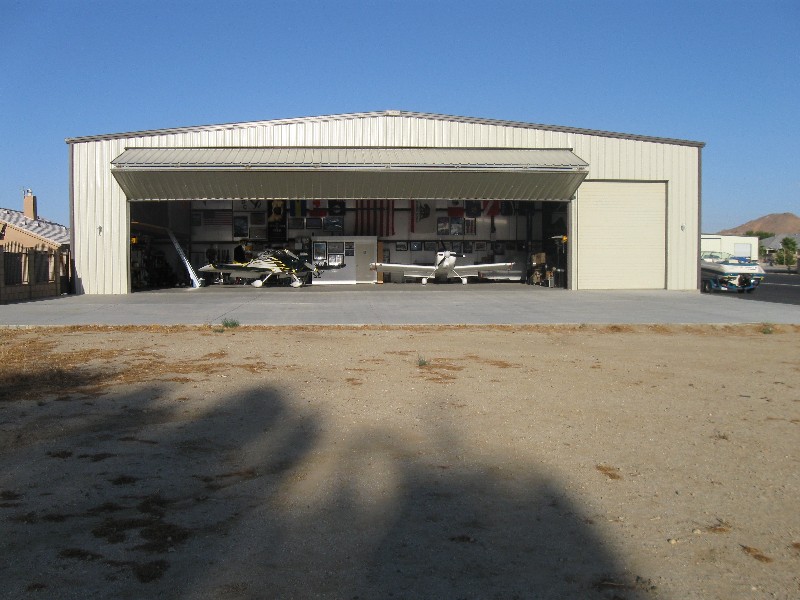

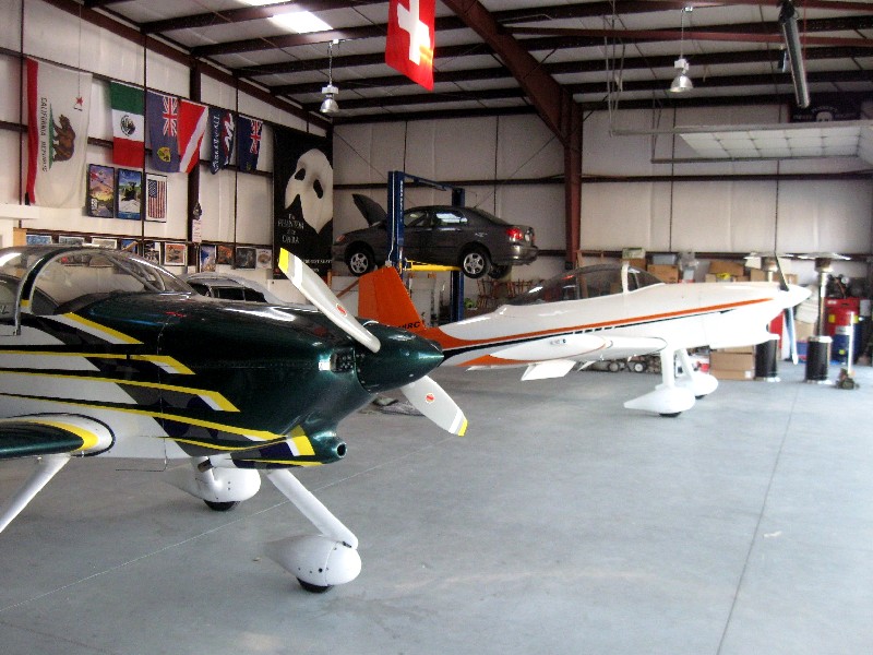

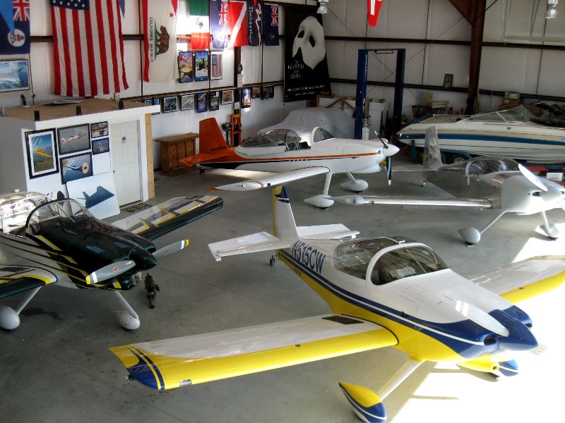

I would suggest you build the biggest hangar you can afford ;) 80'x45' Rosie
Vince, I built a 67 x 50 hangar on my property a few years ago. At that time, it was cheaper to buy a hangar from the manufacturer, and be my own contractor. A local company did the erection, it was a big task taking 3 guys 10 days, with several 1 ton beams to move.
A note on the depth, most hangars come in 25 ft max. deep sections. So a 50 ft hangar needs 3 major cross beams, and a 60 ft hangar would take 4 major cross beams. So, if you want to go deeper than 50 ft., it's more economical to go all of the way to 75 ft deep with the same 4 cross beams. your are essentially buying the steel by the ton, and those beams weigh a lot. My hangar was about 12 tons total.
I personally like the non-electric Horton doors, easy for one person to slide, and the snow shield option at the base of the doors keeps out the pack rats in AZ.

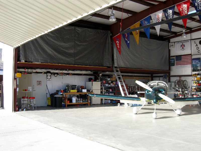

I don't know what hangar manufacturers you are looking at but R&M Steel engineered in a clearspan (storage) mezzanine, 7'x45', on one side of our hangar, and we are VERY happy with it.
Good luck and on your house and hangar! :D Rosie
Lots 'o stuff on the mezzanine behind the gray tarps...
