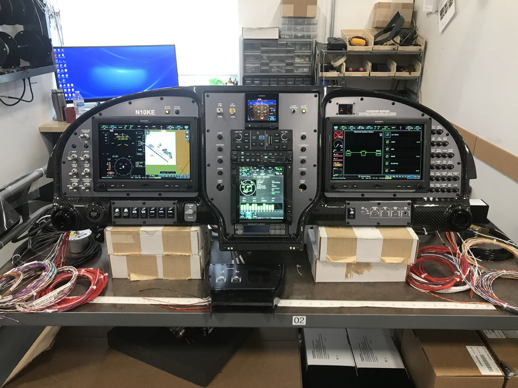

I am putting together my panel/switches for my -10 and I am at the point of paralysis from analysis. I am working with Stein to cut out, paint, and etch the panels and don't want to make a mistake and wish I had something a couple months after it completed. If you think of something I'm missing please leave comments below. Thanks in advance.
I have 3 10" G3X screens, 507 autopilot, GTX 375, GMA 245 COMM Radio, GTR 20 radio, G5 Back-up Inst with 5AH back up battery. There is also a 6AH system back up battery for emergency power. I selected a voltage meter and emergency power switch the instead of using a relay. The left control panel has the following: Start and magneto switch, master switch, avionics master, pitot heat, fuel pump, right cyclic cutout switch, flap switch. Right side panel: Front seat heat variable control, back seat heat variable control, overhead console air intake valve control, rehostat for defrost/avionics cooling fan, ELT remote switch, CO detector warning light. The experimental warning placard will be above the G3X display on the right side. The Aerosport overhead lighting pod will have switches for Nav/Position, Strobe, Landing, and Taxi switches. Wig Wag is controled by the Vertical Power Pro. Interior lighting has overhead dimmable lights, panel light dimmer, footwell lighting dimmer, selection switch for white/blue LED footwell lights.
Hopefully that is clear as mud but able to paint a picture of what I have planned and now for what I don't know which is were you all come in. Thanks for any input in advance.
Chris
Thanks Darwin. I am actually looking at standard toggle switches with backlight engraved panels. I could use some suggestions on panel sources as well if anyone knows of a source. I hate when you see something you like and you know you want it but figuring the details out can be frustrating.

My last change to my panel came when going thru emergency procedures with a mock up. I discovered that I could not pull the trim power circuit breaker if I had a runaway trim and I had to hold the stick forcefully to maintain pitch or roll attitude. So I relocated my trim Circuit Breaker so I can operate with my throttle hand.
So my lesson learnt was to review emergency procedures before finalizing panel.
I did not see a go around switch. Maybe it is on your stick.
Do you want to leave room for a spare or future switch. Cut the hole and cap it (maybe just a pilot hole say 1/8" and capped)

The best advice I can give on the configuration is to mock it up with graphics printed out (or stickers from Garmin if you can get them), then sit behind it and work your way through a typical (and non-typical) flight as stated above. When it feels natural and has a good flow, You have it right. Airplane noises are optional! :D
My suggestion if you plan on flying IFR, ditch the 375/3rd screen and install a 750xi.

Hopefully this works and you can see the moc up of the panel. As far as the 750 goes I was looking at it and opted for the GTN375 to save the money. The GTN will still get you as low as ILS minimums and you don't have to worry about the glide slope or localizer being NOTAMed out. Wx, traffic, maps, Vertical Power management, etc is what the middle MFD is intended for. Unless I misunderstood flight plans can be edited on the GTN and pushed to the larger screens. My mission is primarily a VFR cross country one with the capability to get home if wx is IFR. Great reminder of the go around switch. I had originally had it in the plans and forgot to transfer it from the napkin to the detailed drawings (big save there, thank you). I'll look into the panel lighting suggestions as well. Lots of good things to think about. If there are any other suggestions please let me know. Thx

Personally I love having a center G3X with a GTN650xi. It allows me to have a large chart on the G3X or split screen to look up approach plates. Entering a flight plan on the GTN650xi is painless, even on the small screen. No wrong way to go, just whatever is right for you.
