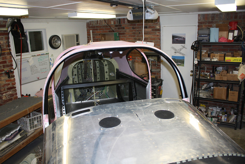

I'm getting ready to install the windshield and would like to cut 2 holes for venting the avionics. I looked at McMaster-Carr but didn't like what I saw
Any suggestions would be appreciated

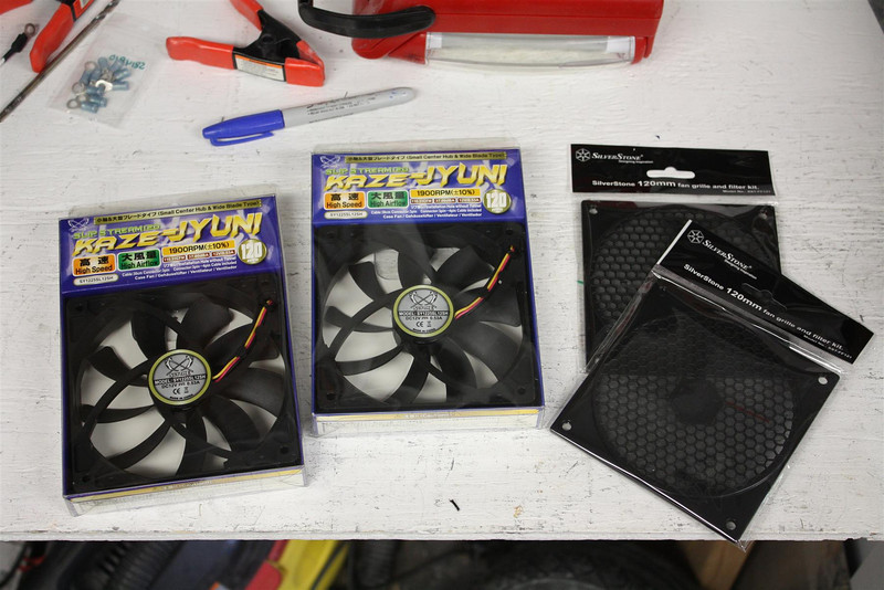

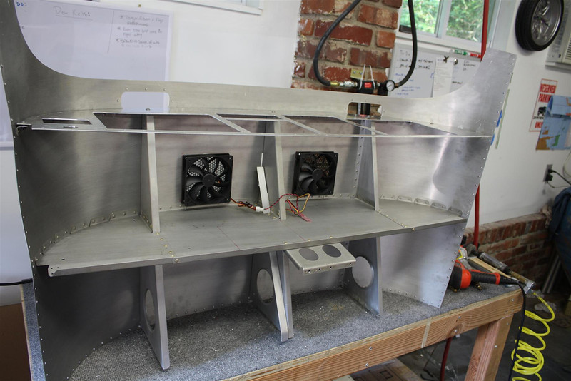

Craig, Here is how I finished off the glare shield. I cut out two holes for standard computer fans, fabricated a doubler, covered the glare shield with Grosspoint fabric, fabricated a couple of deflectors to keep stuff from falling into the avionics and to act like a defroster in the winter. I have not had any issues with 100 deg. days whatsoever. I also of course have a separate avionics cooling fan for the 430 and transponder. Photos below.

Two 80mm fans. We use them on ALL flights below 40F as a defroster. Four people put out a lot of moisture. We also use them above 60F for avionics cooling. No additional fans like Bill P., with no problems on 100F sunny day. Flat black painted, uninsulated glare shield. I am sure Bill's avionics appreciate the extra cooling though.
