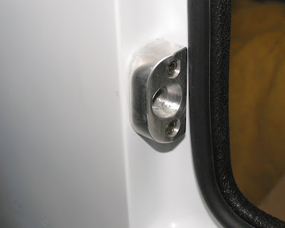

We installed the Hendricks door system and fitted the Cleveland catches, 4 magnets and sensors, a circuit for left and right with alarms into the Dynon D180. Seems to work well.

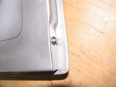

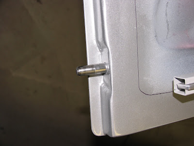

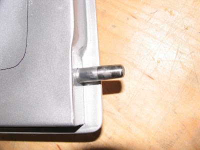

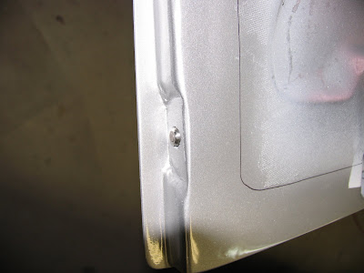

While I did add the aluminum door guides and the bullet shaped magnetic tips,
the rods still protrude more than an inch past the aluminum frame.
The actuating mechanism is stock as per Van's instruction.

Mine work fine but not stock Van's either...Hendricks locks and handles, Rivethead pins and recepticles, properly rigged door switch warning lights..I CAN'T close my doors with the aft pin out of alignment and if I did my door closed light would stay on as well as tweaking my door trying to make it lock.
