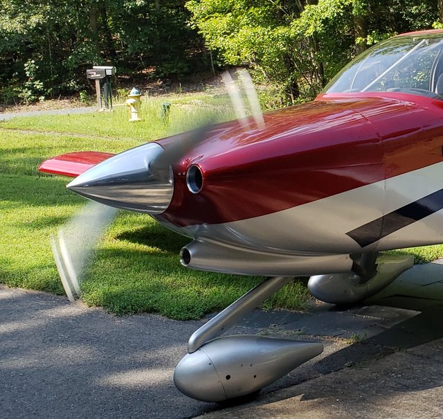

I’m just finishing the tail kit on my second RV. The wing kit arrives the first of May, the fuselage kit arrives the first of June. I’m dragging my heels on ordering the finish kit because of making this cowl decision.
My choices for the cowl:
- Hands down favorite is the James Cowl. I used it on my first RV-10 and found it provided gains in cruise efficiency (as compared to what other RV-10 builders were reporting). The new owners of James Cowl have told me they will soon offer the RV-10 cowl, but I don’t have a time line. There is also discussion of offering one for the stock vertical indiction engine and one for the cold air sump horizontal induction. Here is a photo of my first RV-10 with the James Cowl.
- Backup if the James Cowl does not happen is the Showplanes cowl. In addition to addressing some of the limitations of the stock cowl (like a too small of a spinner), the attraction of cold air sump engine is a driver. Note however that while a stock IO-540 cold air sump engine from Thunderbolt will make 275HP instead of 260 (8.5 - 1 pistions) current price is $58,100. If you opt for 9 - 1 pistions HP goes to 285. For me I’ll stay with 8.5 pistons to have the option of burning mogas if 100LL (or its replacement) costs become excessive. The mission of this plane is high efficiency cruise, not time to climb.
- If all else fails I’ll bite the bullet and get the stock cowl.

We are building the mold now at James Aircraft for the RV10 now. The updraft is first and then we will do the forward facing induction. So RV 10 cowls soon.
