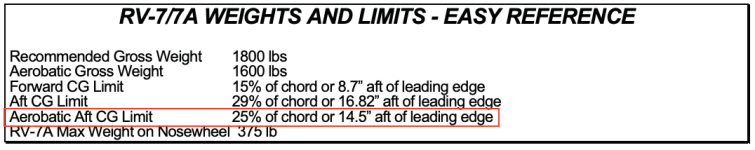

On another note, Van's published aerobatic weight limits for all applicable models. These being 1600lbs for the RV-7/8. What category of operations are expected between this and the max gross weight (1800lbs)? Are we now in normal category (typically 3.8G limit) or utility (typically 4.4G limit)? Extrapolating linearly, we're at 5.3g at 1800lbs (1600 x 6 = 9600 / 1800 = 5.3).
... I'm building an RV-8 ...
For the RV-8, between 1600 pounds (or 1550 pounds for those with the non-Dash-One wing) and 1800 pounds, Utility Category limits apply.
Ref: "Flying an RV" - https://www.vansaircraft.com/flying-an-rv/
"The RV-3B, RV-4, RV-7/7A, RV-8/8A and RV-14/14A have been designed for the operational stress limits of the aerobatic category (+6.0/-3.0 G) at and below their aerobatic gross weights. The operational stress limits for these aircraft between their aerobatic gross weights and their maximum design gross weights are utility category (+4.4/-1.75 G). The RV-9/9A, RV-10 and RV-12 are not designed for aerobatic flight.
The design operational stress limit for the RV-9/9A is utility category (+4.4/-1.75 G) at less than 1600 pound gross weight and is standard category (+3.8/-1.5 G) between 1600 pounds and the aircraft’s design gross weight. The design operational stress limit for the RV-10 is standard category (+3.8/-1.5 G).
No RV should ever be operated above its design gross weight limit."​
Stay with the limits the designer (Van's Aircraft) specifies, or do all the engineering calculations and testing necessary to validate your numbers, taking into account (for all parts of the airplane) flight and ground loads, gust loads, stress and fatigue, and flutter. Depending on what you're doing, all of those disciplines may or may not be affected.

I agree with all of this. But it makes me wonder, since Van's doesn't publish different aerobatic gross weights for different fuel loading, is it safe to say that the aerobatic gross is valid at *any* fuel loading?
Definitely! ;)
Vans has answered that in the past and the answer was “the limit is the limit” or words to that effect. They don’t want to own the grey area where builders/flyers like to venture.

The aerobatic gross weight for all of the different models is listed as the weight limit with any amount of fuel that you could carry in the standard kit built tanks.
Yes, that is exactly what I was asking, thanks. Sorry if that was worded poorly. :)
