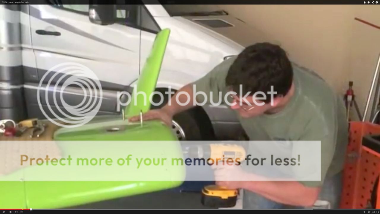

This is our first attempt at building wingtip tanks for the RV-9A. First flight results seem promising! We added winglets to see if it makes any difference. We show the wing and winglet aerodynamics in different stall configurations... The tanks work beautifully and we are super happy with the results
Correction: 14 gallons on each tank = 28 gallons total

Nice looking tanks , not so good looking winglets . What purpose do the serve ?

The main reason for the winglets is to create a high point for the tank vents, reducing piping work. The second reason is that from the analysis, the forward swept winglet is more efficient than other shapes or no winglet, giving 15% drag reduction, keeping the performance the same, even with the additional tanks. In other words... we have now twice the fuel, and no loss in performance... or at least that is the goal.

Wait, I recall winglets have been discussed in this forum. One camp was concerned about them because the wing isn't engineered to handle the twisting moment created by wind forces on the winglet's outer forward edge. How have you addressed this?

Very interesting and valid questions.. Although we haven't done all the tests to be able to answer all the questions, here are some interesting things we made:
- The tanks actually give 4 more hours of flight at 145 Kts.
- When building the airplane, the main and rear spar were reinforced, to handle the weight of the tank and the twisting moment of the winglet.
How does the winglet stalling affect the angle of climb?
From the tests, the winglet started stalling at 60 kts, which is not ideal, but we normally climb at 80 its, and during our standard climb, the winglet did not stall.
What are the forces that the winglet imposes upon the wing structure?
Don't know.. we made it very strong. More tests to come...
Do you plan a production run?
Negative. This is just for fun and to be able to go the distance.
PS: The RV9 is an amazing airplane as is. It does not need winglets.

Very interesting. The video suggests a few questions.
Do those forces account for the winglet stalling, as shown in the video, which would decrease their lift and increase their drag at wing angles of attack below the wing's stall?
Did you make any structural modifications to handle those loads?
