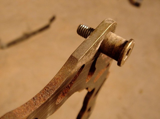

I had one brake dragging, and it was due to corrosion on the pins causing them to bind:
This can also lead to uneven brake wear.
It's now my habit to very lightly apply disc brake lube on the pins with a q-tip, more or less monthly.
In short, I think a tiny bit of lube on any brake part that's designed to slide is a good idea.
