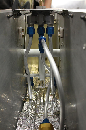

Guys,
I'm going changing out the original Van's fuel selector valve for the Andair and I'm not for sure which Andair valve and extension is needed, I really don't want to tear down my tunnel to measure to order, so if someone has installed the Andair fuel system and has the numbers, Please post or PM.
Because of the time and freight from Andair in ENGLAND, I want to measure twice and cut once, however, it appears I'm too lazy to dismantle my tunnel to measure myself,, well,, at least I'm honest abut it!!

The short answer is yes you'll need the extension. How much depends on how old is your fuselage kit. For the current kits you'll just need 3-4". The older kits the valve was mounted higher in the tunnel. A 6" extension should be fine.
As to which valve, you can use the wizard on their site to determine with type of connections you prefer. They have quite a few. I don't have the part number I ordered handy.

No extension
Why bother with an extension?
Since you are replacing Van's valve which is mounted to the lid on the tunnel why would you you want to mount the Andair lower in the tunnel with an extension?
Mine is mounted to the lid and this way there is room to accommodate the heater hose for the rear seats.

Same here, works great. Just route your heater hose below the valve, making sure the hose doesn't rub on the rudder cables.

We installed our Andair higher up too. We put some fire-sleeve around the fuel lines where the scat tube passes through to protect them. You may consider purchasing a swivel T fitting from vans: http://vansaircraft.com/cgi-bin/store.cgi?ident=1349528274-106-258&browse=hardware&product=F-Swivel-Tee
