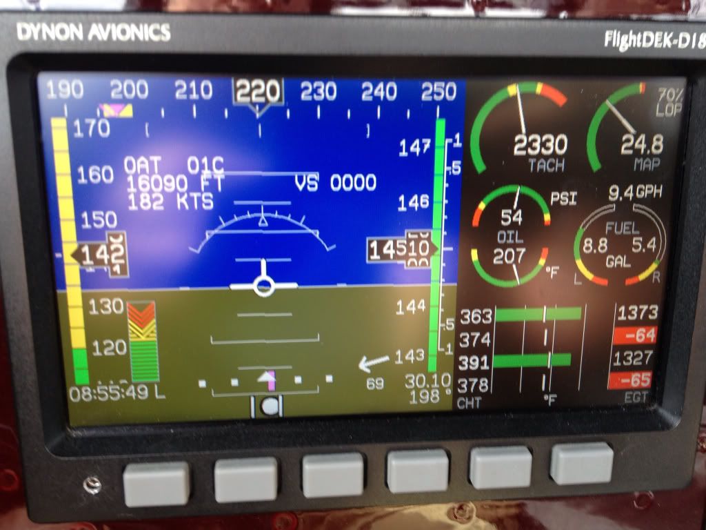

So after a lot of testing and running flawlees it was time to run at 17500 feet just to se what i could get for mp at this alt i climed right up there testflight was only one hour
It just runs very nice and fast
Have a good 4th of july
Mike
Be Careful.......
20 Kts TAS over redline.
You could be breaking new ground into unknown territory regarding flutter.
If you think not, because of the low indicated airspeed, you should probably read THIS

Fuelflow question how much fuel does a o 360 burn at 2700 rpm with 27.7 mp @ 98% mine takes 13.1

I have a question on the flutter issue. Looking at the screen shots it appears that the IAS is 150 kts or so. The TAS is 220 or something like that. Since VNE and flutter are related to IAS and not TAS I don't see the concern with flutter here as the IAS is below VNE. Am I missing something?
Nigel
Yes, you are missing something. A lot of us missed it along the way, until an article was posted on Vans Aircraft web site. Click on THIS to read the informative article. It is a link to a .pdf that will download. It turns out that flutter is directly related to True Air Speed (TAS), not IAS as we all used to think. Hence the concern in the thread.
Nigel
true vs indicated
Okay, I understand the need to treat use the true airspeed Vne limitation to avoid flutter. What I don't understand is why I have never ever seen this mentioned in any magazine or flight training material regarding certified airplanes. Piper, Beech and Mooney (older, non-turbo) seem to treat Vne as an indicated airspeed limitation.
That, too, is addressed in the linked article above. Some airplanes have a barber pole on the airspeed indicator that points to Vne and that pole decreases with altitude to account for lower indicated/higher true. The Navy T-34C is like this. The normal Vne is 280KIAS and that is where the barber pole points while sitting on the ground. But as you climb towards 25,000ft, that pole begins to decrease. I believe it gets down to around 250KIAS at 25K'. Hope this helps.
It is all a question of how the aircraft is designed, and exactly what it is that requires VNE to be where it is. In general, type-certificated light aircraft have VNEs that are defined as a specific calibrated airspeed value. The manufacturer has shown that the aircraft is free from flutter to VNE + some margin, at all approved altitudes.

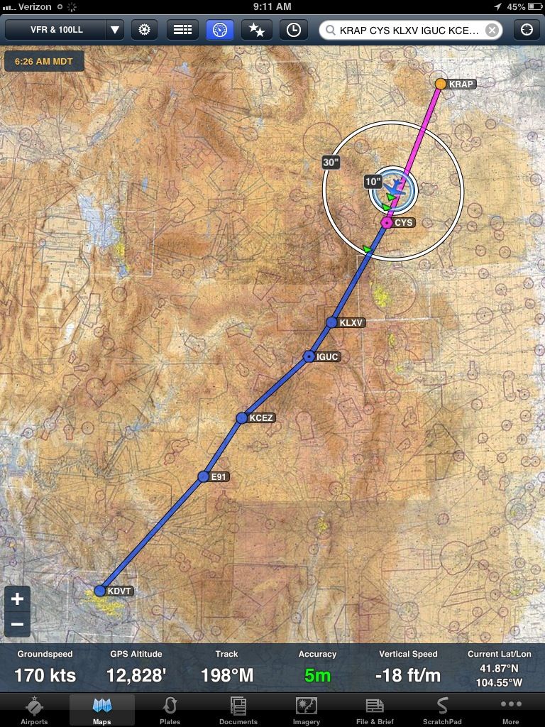

Better than most " cars "

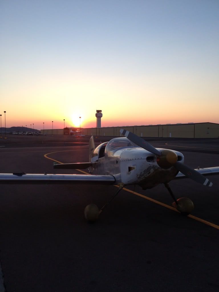

Kdvt to krap via klxv
So wheels up at 5 am going to sturgis for the bike ralley 2 hours and 26 min to leadville got that crossed of on my bucket list and gas was only $4.95 Andy the airport manager was very nice.just for the fuel its worth it to go
During runup i set the map to 26 inches and takeoff was no problem
After that it was on to rapid city total flight time was kdvt klxv krap 4:27
I planned the trip at 180 ktas aopa said 4:26 so i guess it was close
Fuel for 759 nm was 42g
Temp in phx this morning at 5 am 94 rapid city at 4 pm 75
It is so nice to cool off
Plane was ok

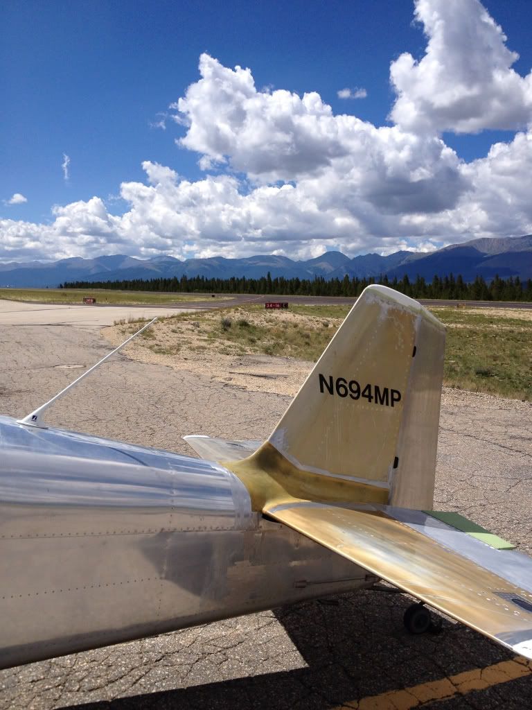

The plane was ok after the hail storm. KRAP to KLXV was just 2:00:35
No sign of andy but we filled up with $4.95 fuel and then bag to KDVT flight time total was 4:38:26 so a little cross wind slowed us down but not bad at all and i got to se mount rushmore small diviation from the curse
On the ground in leadville
