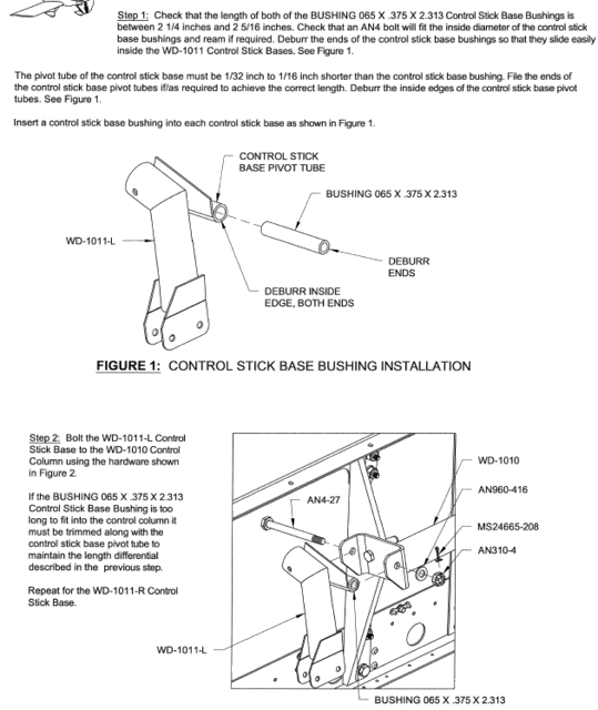

I was working on assembling the Control Sticks today and wound up with an issue. In the photo below, there is a bushing that gets fitted into the control stick base. The bushing is supposed to fit an AN4 bolt, which it didn't so I reamed it with a 1/4" drill bit. Then the bushing was supposed to go into the control base, but it wouldnt fit. The bushing diameter was .375 as expected, but the powder coated base was just undersized. I deburred the edge on the base thinking that would help, but the bushing would go - even with a plastic mallet. I then deburred the outside edge on one side of the bushing, still no go.
So I decided to try to ream the Control Base. I use a 3/8" drill and placed the piece in my drill press. I slowed it to the slowest speed (620 rpm) and applied a good amount of liquid Beolube. I VERY slowly lowered the bit and it wasn't more than a second or two before it starting smoking and the heat was obviously building up as the powder coating started to shrivel up and discolor. So I stopped, let it cool and figured I was going too fast. So I waited a few minutes, more oil and tried again, same thing.
So I'm wondering, did anyone else have to ream their parts or was I just unlucky? If you did ream them, any pointers on how to do this without smoking the piece and ruining the base?

Page 39-8 step 1 says it may be necessary to ream the bushing (brass?) to fit the AN 4 bolt. I had too. No mention of a need to ream the hole in the stick base. Mine fit fine if I recall correctly.

I am referring to the stick base itself WD-1011 (Step 1, Page 39-8). The issue is the brass bushing doesn't slide into the base even once the powder coating is removed. I spoke with vans and they said to ream the hole - which is 3/8" size.
Ok, I went to Vans and yes indeed, it was a case of undersize hole on the stick base and slight oversize on the bearings. So I went and got some NICE chuckable reaming bits from a local machining shop. I reamed the bushings to 1/4" and they were a lot more consistent on the inner diameter than the drill did initially.
I then reamed the two 3/8" tubes on the stick bases. A little smoke, but not as much and I kept it well oiled. I had to grind/sand down the base slightly so the busing actually was longer than the base. On one, even after reaming it to 3/8" the bushing still wouldnt insert smoothly. So I carefully "polished" it on the scotchbrite wheel to very slightly reduce the other diameter to allow it to insert into the base.
It just took more machining to get it all to work, but it did. I had to clean and reprime part of the stick base as the powder coat either cooked off from the initial ream attempt or from the size fitting work. But they are mounted and move freely around the bushing now.

The stick is a welded assembly. The pivot tube would typically be fabricated from 1/2" dia x .065 wall tube, meaning the ID is a nominal 0.370". After welding it would be reamed to 0.375" for a bushing. Reaming increases the bore size and corrects any warpage due to welding.
