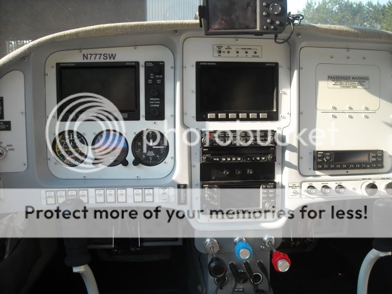

Another option.
The guys in Big Fork, Montana adapted a Lancair panel to my -10:
Modular with three removable panels for access, and silkscreened/ wired by Aerotronics.
Best,
The guys in Big Fork, Montana adapted a Lancair panel to my -10: Modular with three removable panels for access, and silkscreened/ wired by Aerotronics.
Aerotronics makes great panels. Fortuantely, you no longer have to modify Lancair panels to fit an a RV-10. Why not get a panel that was designed for the RV-10? Aerotronics also sells Aerosport Products panels to their customers.
