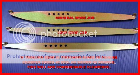

....I set up one of our fixtures today and tried to duplicate the problems as seen in your photo above and took a couple of pictures of our findings. It appears to me that your fairing is mounted too far forward and possibly trimmed in a way that affords less clearance. Or there is some variation in the fairing, hing, rivets on something you received from vans. I have several new stock fairings here and when trimmed and clamped in place with the lower hose clamp mounting they all look just like the one i have pictured below. I can't find more that about .060" variation in any of them. We did find some hinge that I believe came from Vans that was wider and will definitely hit the back edge on the nose job. We sanded a 45 Deg. bevel in the area shown in the pictures and that issue was gone, then all was well. We have some shorter bolt and nut assemblies and I will send you some of those tomorrow. This will give you another .187" clearance at the bolts, Thus eliminating that portion of the problem. I am not saying you don't have a problem with what we see in your photo, but we have not seen it before. We have had a couple of customers say they beveled the trailing edge a little bit to gain extra clearance. If possible, please give me a call so we can try to solve this issue. I can send you a new stock fairing if you would like or, I see you haven't done your paint work as of yet. I will send you one of our ASA fairings (no charge) to affix to your plane. What ever it takes to get you past this is our pleasure
. Just let us know. Thanks Allan... :)

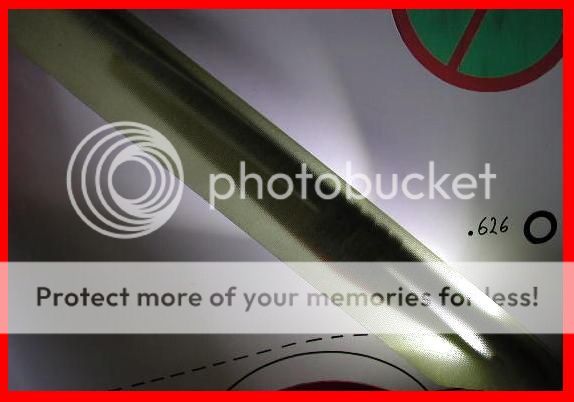

:D... We took all 277 pcs. of the new type we have in stock, set up the mill and did the mod on them just today. It is virtually impossible to make them hit now with this material removed. All future runs of this product will be this way. These will need to go to the plating shop tomorrow, get stripped and re-plated. We will be shipping them again in a few days with all mods and plating finished. Thanks guys, Allan:D

....Sorry for the delay, as I just revisited this thread and discovered your request. I looked back through our records and found that we had only one installation that we had modified, with the taper, that had a stock fairing interference problem, (not bad out of well over 200 modified units). This hardly seems an issue, but, here are the dimensions you requested. Thanks, Allan... :D

.... This hardly seems an issue, but, here are the dimensions you requested. Thanks, Allan... :D
