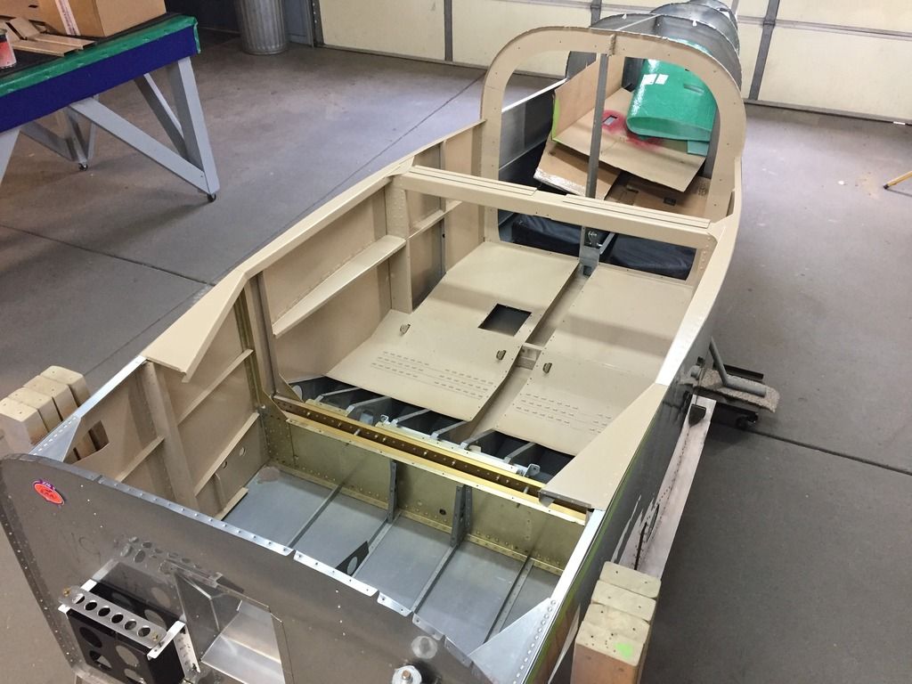

Completed a good portion of the interior painting this past weekend. Parts were primed, sealed and color coated, came out great. Had to use low temp reducer, but painter Greg does this every day.
Now we can continue more of the fuselage assy!
This was the primer stage
In the paint booth, you can see the exhaust fan in the background
Heater/Poor man's make-up air system! It was about 35 Deg F outside Saturday.
Completed initial paintwork, ready for continued assy.

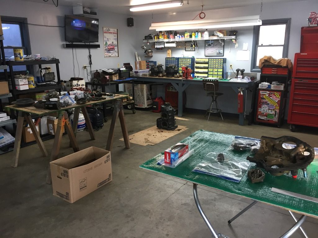

This past weekend we started into an exciting phase for the build, the overhaul of the O-320-D3G engine! The core engine had come along with the entire project purchase, and I've been patiently waiting to do the teardown to see what we have.
It was a rare January thaw up here in SW Michigan, the thermometer topped 60 degrees last Saturday and we even opened the shop doors for a bit to let some of the sunshine and outside environment in. You can get cabin fever up here this time of year and this was a day to ward that off. RV building it turns out, is a great cure for cabin fever.
With the help of our local EAA Chapter 221 Tech Advisor, we tackled the complete disassy of the engine. Things look pretty good overall, no visually severe corrosion or damage, however as always, the NDT and other checks at the repair stations will tell the final tale on what we have.
For now it looks optimistic that we have a good core, I'm doubling my knowledge of this Lycoming powerplant and how to orchestrate its overhaul, every day. Lots of good advice coming in.
Just have to be brave when the repair invoices show up! I'm fastening my seatbelt...
Andy C.
Here's our starting point
Pistons and Cyls removed
The case
Parts to be organized
And the work area. It took another few hours to organize the parts and bag things up. Soon we'll be sending parts off for component level overhauls!

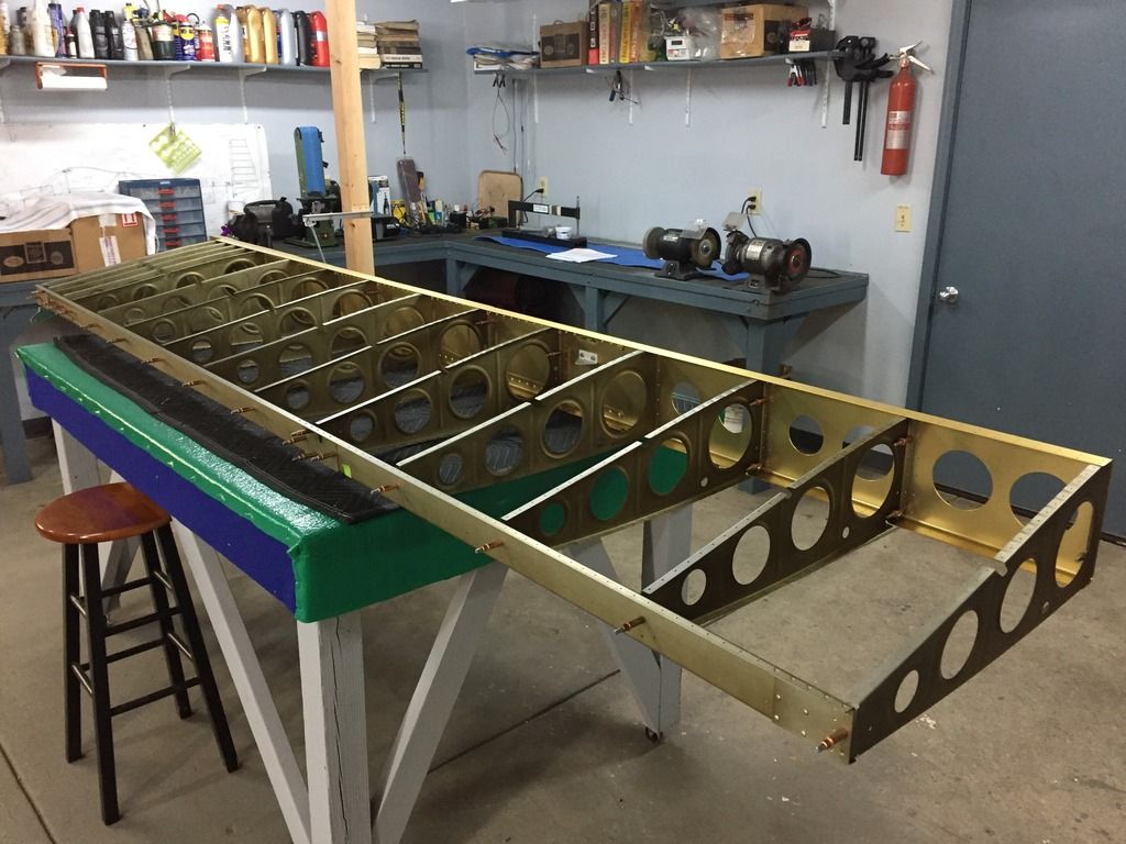

Some more work this past weekend. Riveted the ribs to the spars on the right wing, and put the top skins on for match drilling. Lots of holes I'm starting to realize! I find I will need more silver Cleco's....
Wife made some RV builder brownie's for the group of us, which powered us through the day. (there's a few of the local EAA Chapter members that I suspect like to escape Saturday honey-do's, to work on an RV)
Right wing in the holding jig:

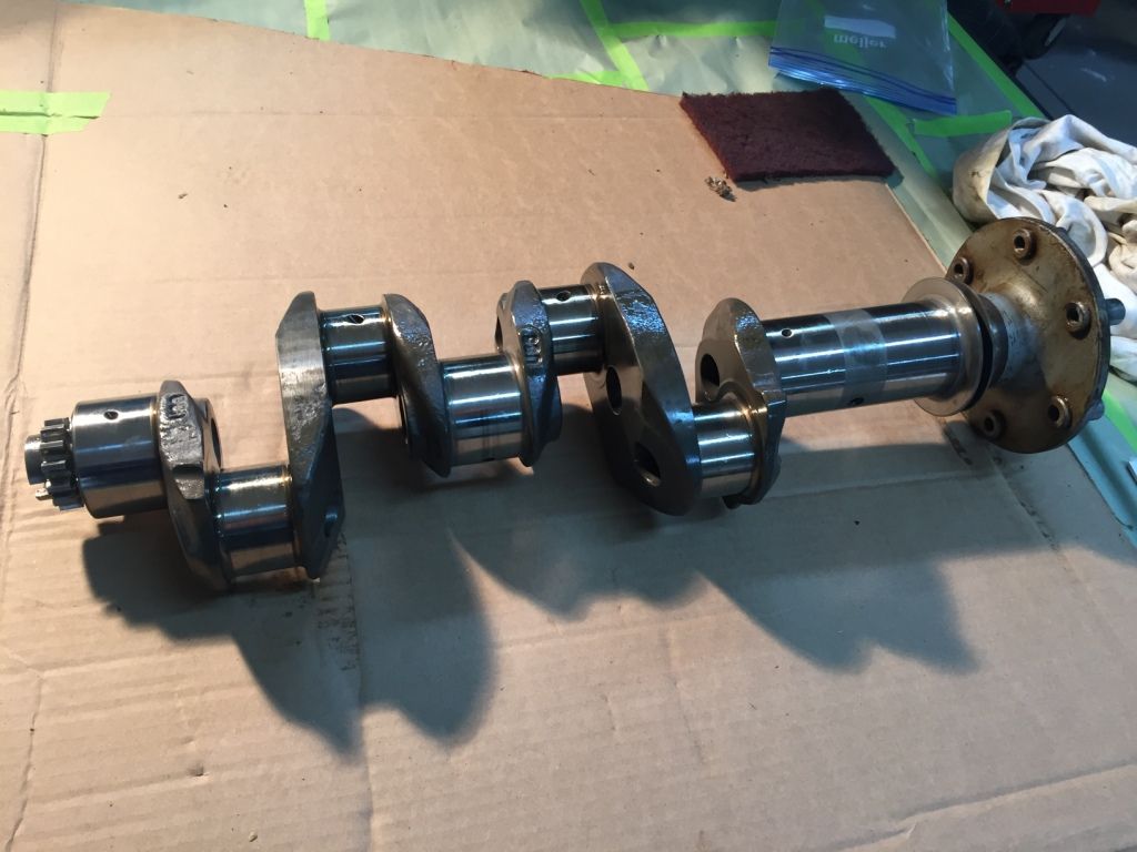

Here's the crank from the 0320-D3G that we're preliminarily inspecting before sending out for full checks. People seem to have all kinds of trepidations about these hollow cranks, we're hoping that it's still serviceable. Advice to me has been, "If you don't have a crank, you don't have an engine". We'll see what happens.
