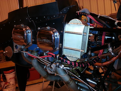

Paul,
I have an 11 row hanging on with a nice substantial mount. Look here
http://flic.kr/p/k91cqF
Hard to get the full pic, I will email more to you when I find them.

Old 03-11-2015, 04:10 PM
Posts: 3,750
Originally Posted by C-FAH Q View Post
Paul,
I would be interested in any pics as well, Gary, if you're willing to share. I'm thinking about trying to put a bit bigger cooler on my 0-320 that what came stock in the FWF kit, but want to be to keep it on the baffles as well.

Found the pic I was looking for.
[IMG][/IMG]
I that bracket ever falls off, or cracks, I would be shocked.

Another example of a reinforced baffle-mounted oil cooler.

Thaks for the pics guys. I am also a member of the "reinforce it until you can lift the airplane by the oil cooler" camp when it comes to baffle mounts. I got some drawings from Pacific and will have to make a block of foam and do some fit tests. Firewall mount is possible using the RV-10 setup, but my number 2 choice just to keep things simple.

Gary-
Is that just U-channel that you used to stand the cooler farther aft off the back of the cylinder? Did you do that to make the cooler fit better or just to allow more air down to the cylinder and/or cooler?

I actually had a 13 row Aero Classics cooler mounted on the rear cyl 4 baffle of an RV-8 {parallel valve ECI IO-360) for one trip to Oshkosh and back. Afterwards, we discovered it was rubbing on the engine mount frame tubes, and a little bit on the fiberglass upper cowl too, but *almost* cleared both obstacles. The physical mounting was just about the "lift the airplane by the oil cooler" variety when I was completed with it. We ended up replacing the cooler with an SW 10599R cooler which fit without rubbing and provides almost enough capacity to keep the fire breathing Titan IO-360 with piston oil squirters cool on a hot Texas summer day.
